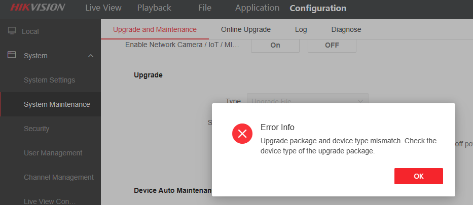

I had seen that firmware too and figured it was a mistake... probably firmware for an NXI type NVR.... anyway, I just tried loading it on the DS-7616NI-I2/16P spare NVR I have:
