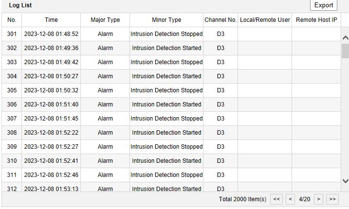

Intrusion detection filling up logs?
Llordlucan
Greetings.
Wondered if anyone can help. I looked at my logs in my DS-7616NI with Accusense Darkfighters and it is full of intrusion detections. I don't get notifications for all these in the app, but do get notifications for legit intrusions. Any idea what s going on here ? Thank you
Wonder if you can help
That cam is tripping every minute or so. Something is wrong with your settings. You should revisit your min/max boxes, threshold, etc.
I suspect you're not getting all those because either the NVR or the app is overwhelmed with sending so many notifications.
