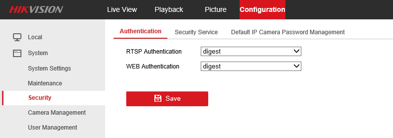

Ah, thanks JB1970. I didn't know it could only be done at the NVR GUI. I was looking in the web GUI.
Edit: actually, I may have misread your answer. I just noticed you said 'NVR web GUI'. I may have mistaken that for the NVR GUI on the actual unit. Thoughts?

My bad. I only checked my I series on V4 firmware and it’s there. Just checked an older E series as well as a K2 and the function is missing there also.
Start by altering your server port number. I’ve never had to resort to IP filtering to block access attempts. Alternatively could you block it in your router firewall?
So I guess even though my NVR is on the latest firmware (V4.30.000 build 200508) I'll never get that option?
