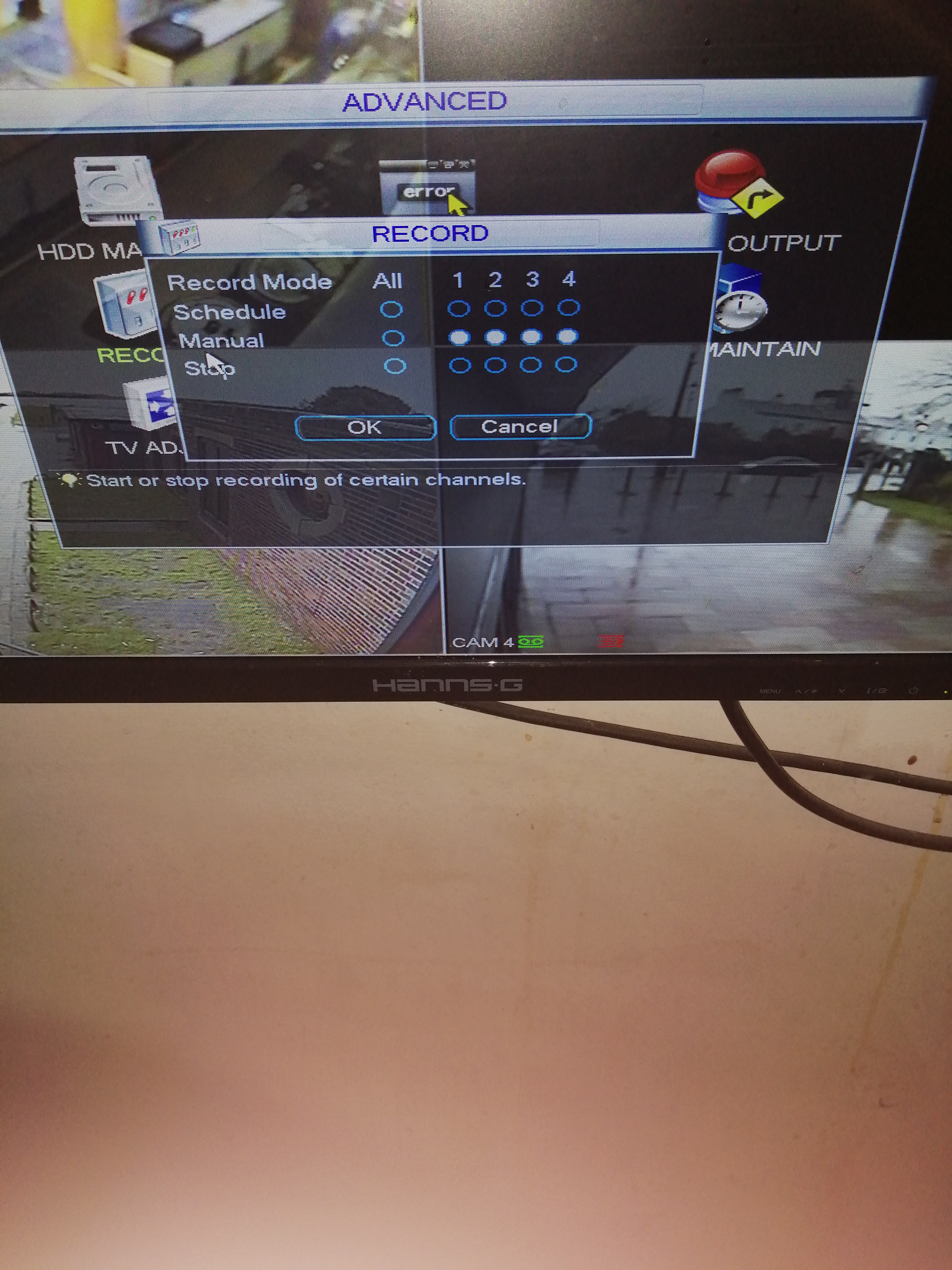

I have configured the recording schedule and activated it all except for one screen which doesn't want to save changes. See attached.
It's the Record screen under Advanced menu option. When I select Schedule or Manual and click Ok the setting doesn't get saved.

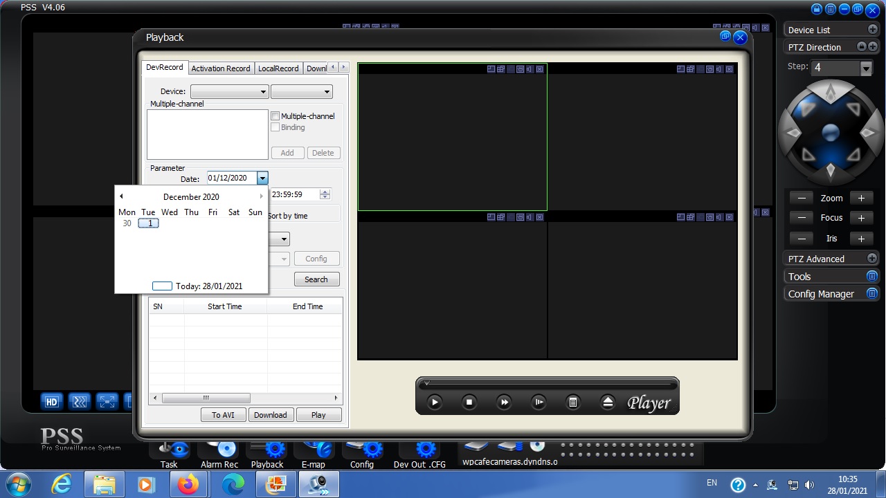

I am using PSS client to view the DVR remotely. When I go into Playback this is what I see. Even after these changes. I think the 01/12/2010
date is the date when the disk first ran out of space. I'm not sure what's going on there.
Anyway, it's still not recording and I am out of ideas. Any advice would be appreciated especially if you are familiar with this machine.
