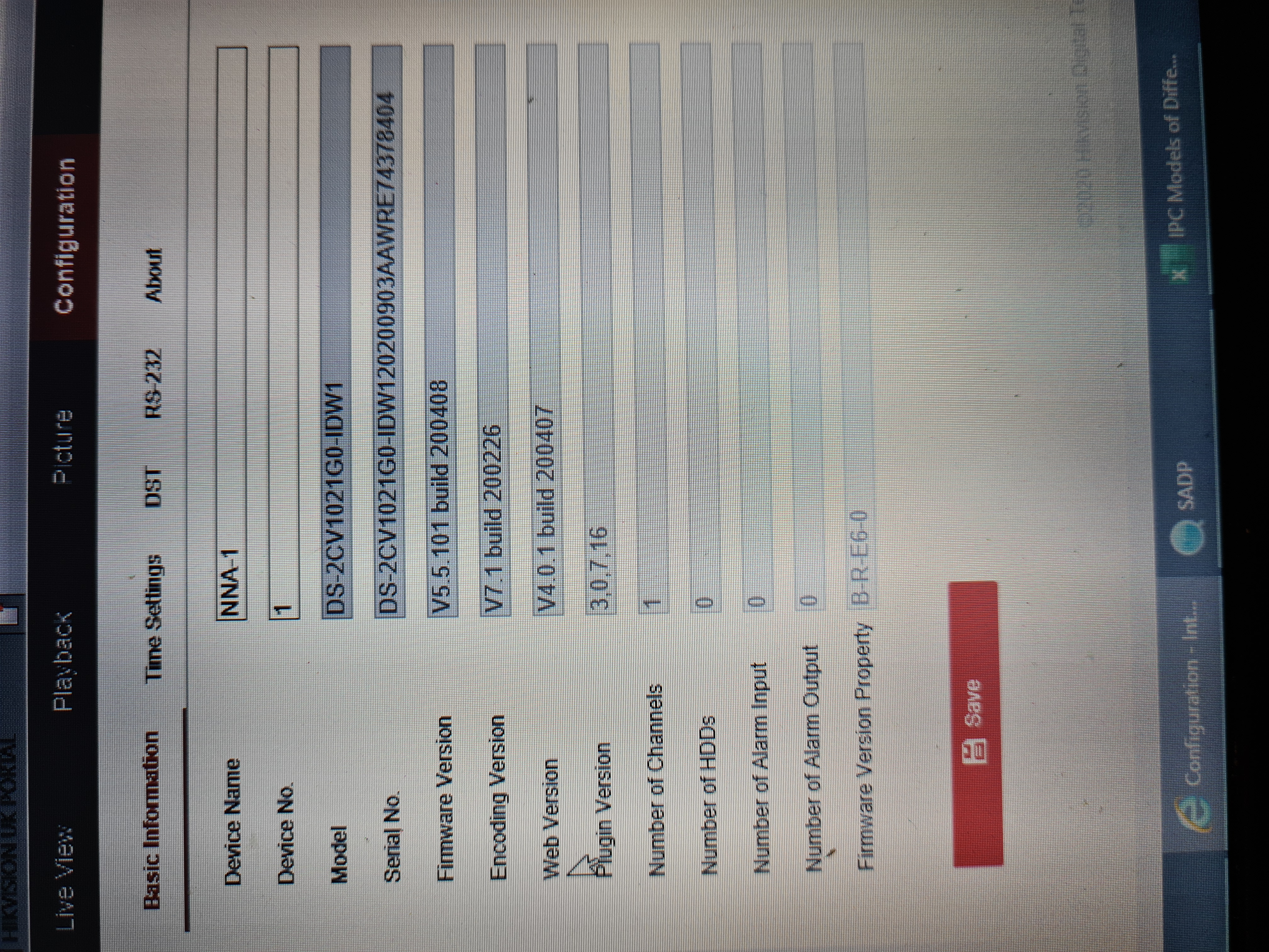

As new, the firmware is 5.5.101 build 200408

In the photo from early post here, you can see that FIRMWARE VERSION PROPERTY contains refer to E6.

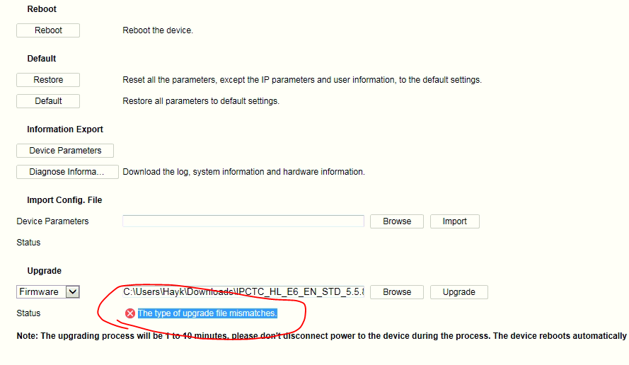

Could you guide, I have similar model, and tried 3 above mentioned version to upgrade it brings error: "The type of upgrade file mismatches. "

Hi Dan,
Thanks for your response.
Tried your suggest firmware - the same issue. Any other suggestion?

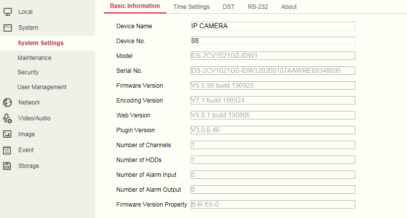

BTW, in Firmware version Property, I see E6, how it came to be E4 ? from where you get that info ?

Are you sure your model is 2CV1021G0-IDW1 and not 2CV1021G0-IDW1(B) or 2CV1021G0-IDW1(D)?
Are you able to access the label on the camera and/or search for the device using the SADP Tool?

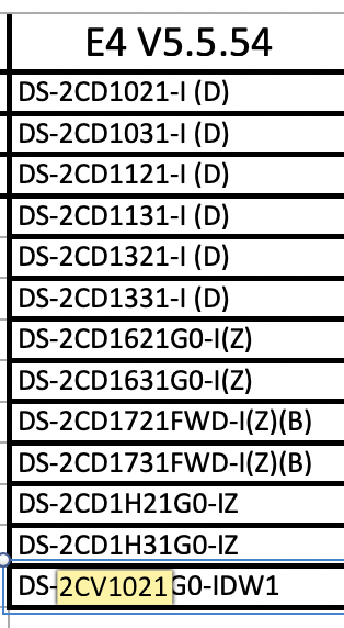

What is confusing is that your specific model is labelled a E4 Platform on our firmware compatibility document (see attached screenshot) and the (B)/(D) versions are labelled E6 Platform, so all I can think is that somehow a non-(B)/(D) model has been loaded with E6 firmware when it should be using E4 firmware and now you can't upgrade to the new E6 firmware or downgrade to E4 firmware due to a strange camera/firmware mismatch.

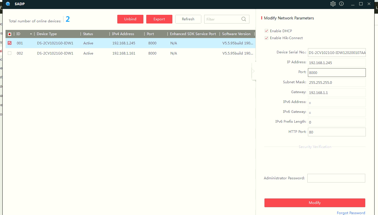

Hi Dan,
yes I am able to search and find camera using SADP tool. screenshot attached. (I have 2 cameras the same versions)
