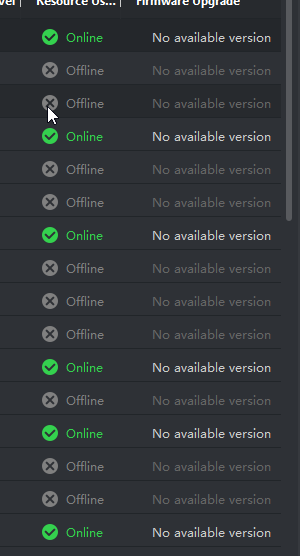

I have a problem on IVMS 4200 after restart of the app. The problem is that all hik-connect devices are being disconnected and duplicated the same time, but the duplicated device is the one that is online.. it is so annoying because I have to set again the cameras (encrypted pass, reorder etc.). Has anyone had this problem before?

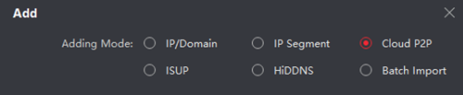

Were all of the devices added to iVMS-4200 through Hik-Connect, using these 'Cloud P2P' adding method?

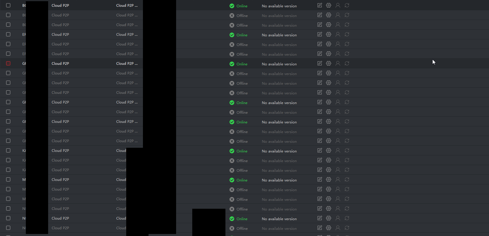

Could you share a full screenshot of the device list in the software please? (We don't need to see the serial numbers or IP addresses.)
The devices were all added using cloud P2P, in order to make them work I have to logout and login back again on P2P but that is not a fix. Because I have to reorder the cameras,group them enter the encrypted password.. It is annoying.
It's an unusual issue, are the duplications a recent issue? Have the cameras been added multiple times to the Hik-Connect account?

No they get added each time I restart the app. I tried what you said still the same issue
