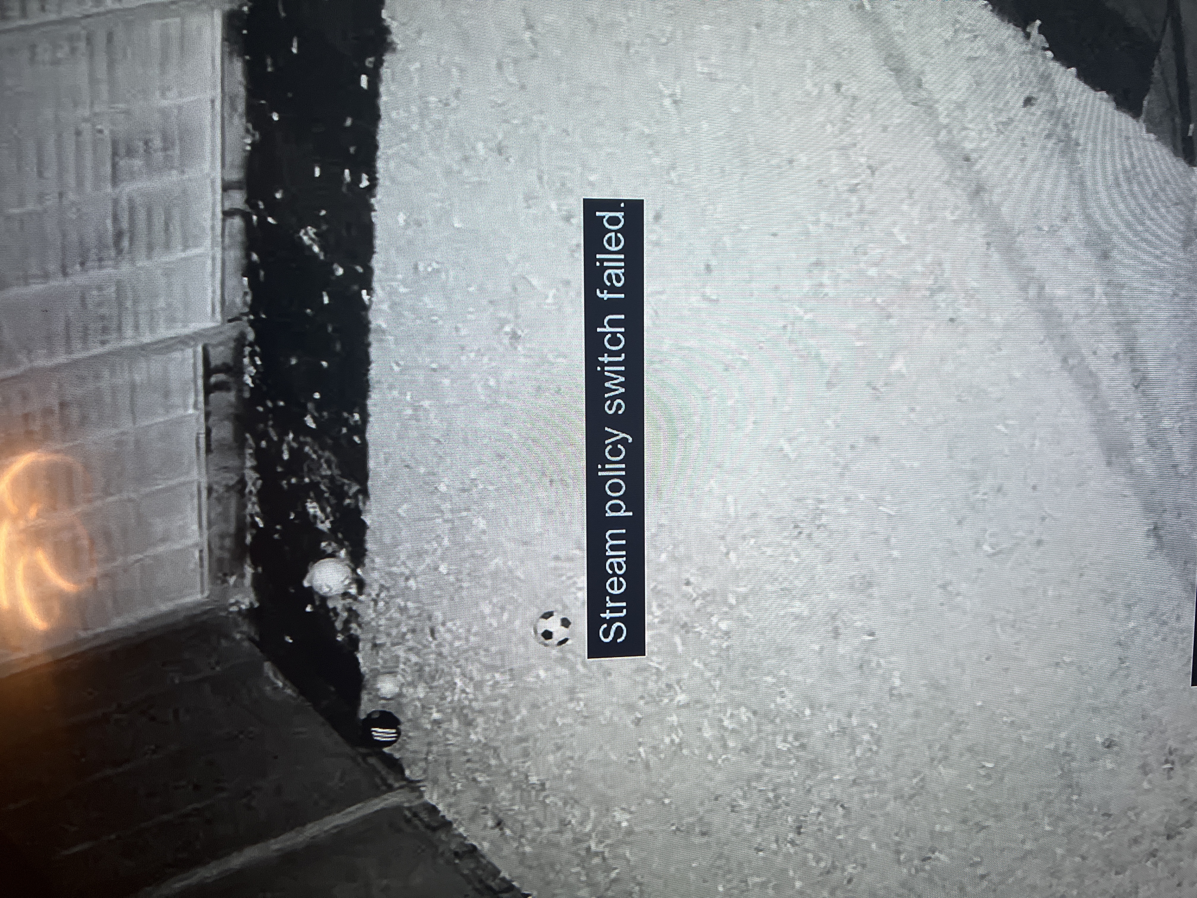

Hi
Was wondering if anyone can help?
I have lost sub stream on 2 of my 4 cameras.
Had this problem before but resolved it by climbing on a ladder and doing a hard reset. But I don’t want to be doing this every time.
Can I do a hard reset any other way? Why does this always happen when I have a power cut
On the hik app I can see the 2 cameras only in hd it won’t let me put on basic.

Hi thank you for your reply.
Got it working by doing the virtual host feature. Many thanks for that.
One more issue I’ve got is after I got the the cameras working I disconnected the 2 cameras from the Poe and connected it back and get the same issue. Loosing the sub stream. So if I ever get a power cut again I will have to do the following again.
Do you reckon the Poe could be faulty?
OR THE CAMERA COULD BE FAULTY?
The camera models are DA-2CD2385FWD-I
And the box is running On The latest firmware ds-7604ni-k1/4p(b)
It only happens to the 2 out the 4 cameras I have
