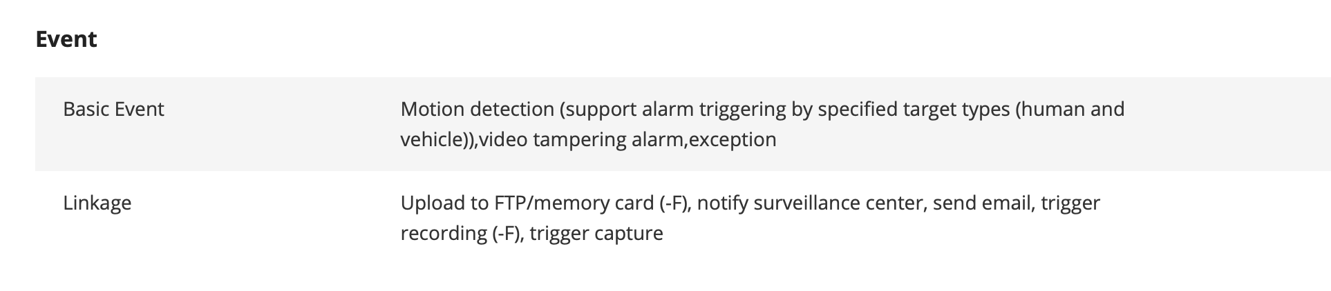

Yes they are definitely incompatible. You need to look at the data sheet before buying the cameras. They will say if they support Smart Events such as Line Crossing and Intrusion. Below is a screenshot of part of the data sheet for the DS-2CD1347G2-LUF. It only has Basic Events:
Save yourself time and money. Check the data sheet specifications before buying the camera. If it doesn't mention a feature, it doesn't have that feature.
