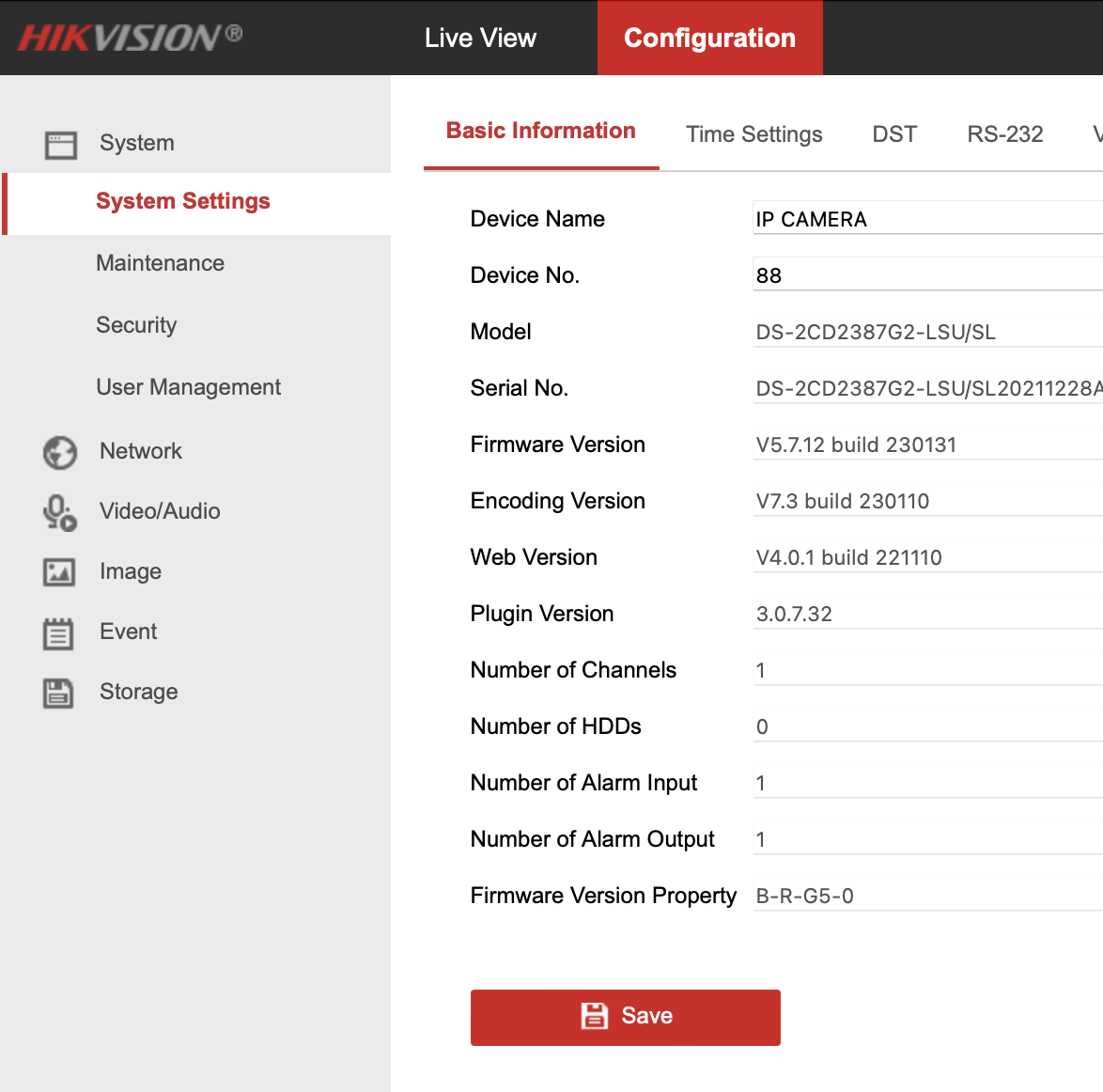

I can't remember what version had the issue but I'd make sure that you're on the latest version for your model. If your model is a 4K turret with strobe it will be a DS-2CD2387-LSU/SL and it'll likely be a G5 firmware model. Assuming you have Virtual Host switched on in the NVR; Log in to the cameras web menu either from the link in the NVR cameras page or directly. We need to know the model, firmware version and firmware version property as shown below:
Mine above is a G5 with the latest firmware.
With regard to showing the detection. When you have it switched on you'll see a green box appear around moving cars and people, along with a green box for your intrusion target area. When a trigger occurs, both the targets outline and the intrusion box turn from green to red briefly. So if a red box appears around your own car you know that is the trigger. However I'd concentrate on making sure your camera and NVR firmware is up to date before going any further.

Just had a look it is DS-2CD2387G2-LSU/SL and Firmware V5.7.3 build 220112. I did a firmware update maybe within the past few months or so IIRC.

That firmware is quite out of date - the build date is 12th Jan 2022. I would start by loading the latest which is on the bottom of the product page here (assuming you're in the UK, else best to find the relevant page on your regions Hikvision site). It could be that updating the firmware resolves it - there have been five builds between yours and the latest:
Correct you can only see the activations live. The logs unfortunately will only show generic information such as 'Intrusion Detection Started' alongside the channel number, so that won't help. But try the update first as it's pointless looking at an issue that might have already been fixed.
