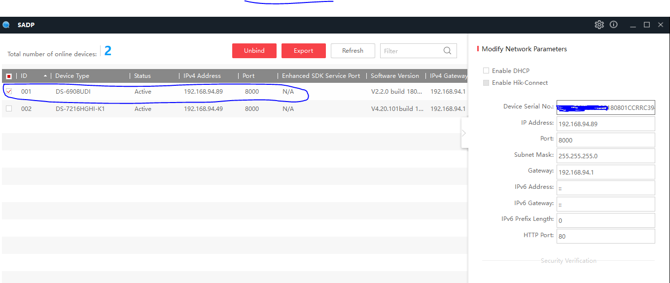

Hello
I have tried to change all cables but nothing changed, find screenshot from SADP Tool

Thanks, what are you seeing when you cannot connect in iVMS-4200? Is the device showing as online in Device Management?
Can you get to the configuration menu for the decoder when connecting to it in a web browser? If so, try upgrading to the newest firmware for it here - Hikvision Download Portal: DECODER_69UD_EN_2.4.0_200608
And perhaps then hard reset the unit and any connected cameras if you're still unable to access it, you may need to use the pushbutton for the cameras:

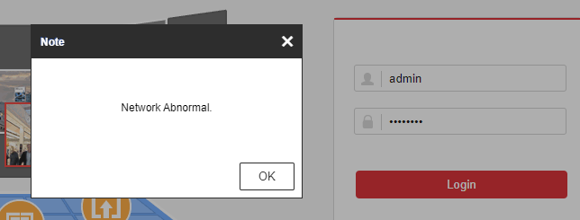

Hi
From, iVMS-4200 it can be seen online, but not added on Device Management list, and if you add it, seems iVMS-4200 cannot connect to it.
Screenshot 1:- error from iVMS-4200
Screenshot 2: error if you try to access from web browser
