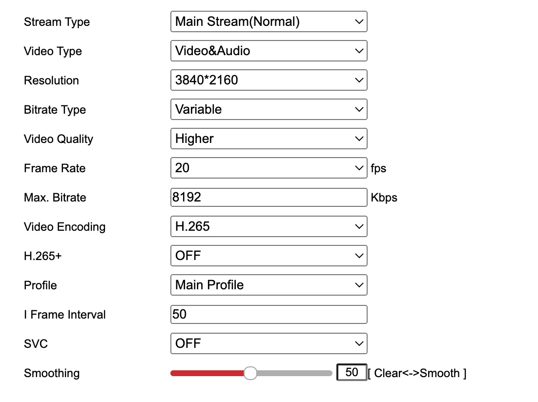

Cameras - 5 X DS-2CD2387G2-LU running firmware - V5.7.3 build 211222. Video spec is the picture uploaded
