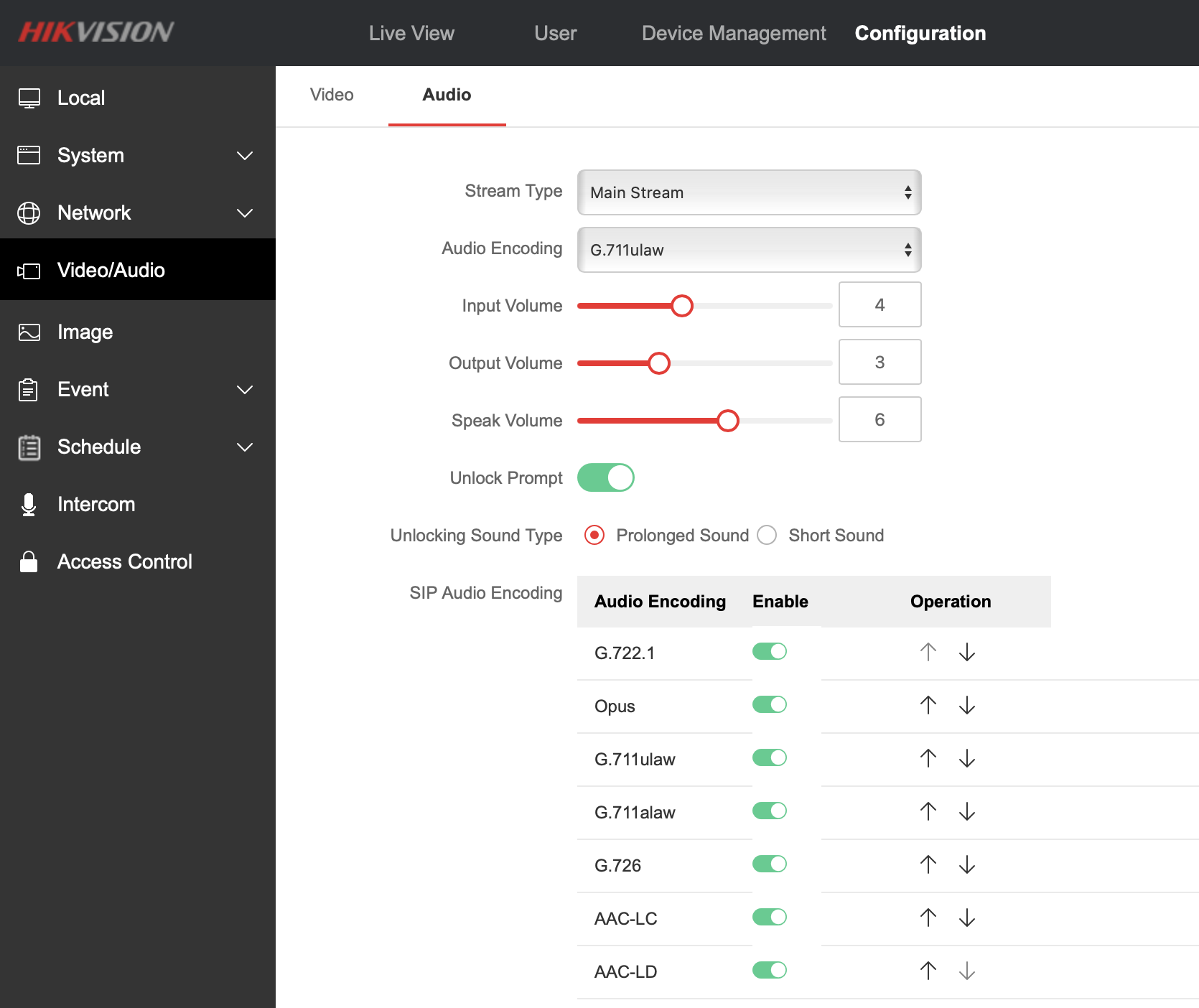

Check the settings in:
Configuration > Video/Audio > Audio
Check both the Unlock Prompt is turned on and whether you have Short or Prolonged Sound enabled:
If it's already set correctly I'd try disabling Unlock Prompt, saving, re-enabling, saving.
Yep did all that. Also saved and resaved on short and prolonged.
Tested it as well. The calling sound it now makes is either short or longer.
Also rebooted twice.

Maybe a bug then and you'd have to downgrade. I use mine with the lock output set to 'Mechanical Doorbell' so cannot test.
Hi Vaie
I do not have the (C) of DS-KV6113WPE1 but the first version (A)
There is no similar setting for Unlock Prompt in Video/Audio settings but what I can see is that the equivalent SIP Audio Encoding is called Audio Encoding for the (A) version and the only option is G.711ulaw.
Can you try changing this setting by moving this G.711ulaw from third place upwards to first place?
I don't know if this is related with Greek language support and if this setting worked with your previous firmware

I think that audio codec settings were in the release info.
I had the same idea as you did and it didn’t work. Tried other languages as well
