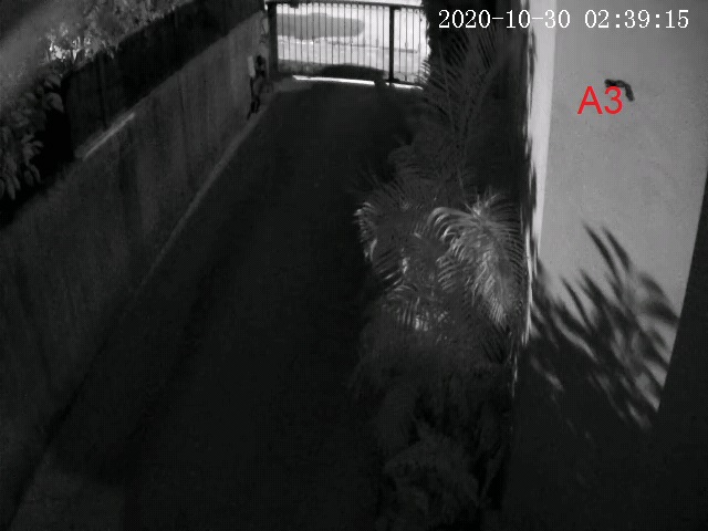

Enclosed are pics from the two cameras. I don't really have a problem with Camera A, only Camera B - but enclosing both because it explains the situation better.
Camera A points up the lane and towards the road, so gets much more light from the streetlamps than Camera B which points down the sloping lane, away from the street.

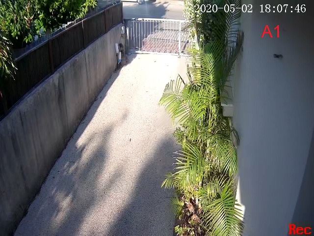

Picture A1 shows camera A at daytime.

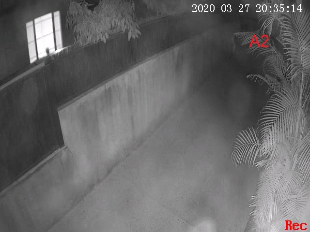

Picture A2 is an older pic, before the change - night, but IR pic is clear.
Picture A3 is new - things can be seen clearly, but chances are that's from new streetlight flooding the scene rather than from IR (see clear shade on wall and how lit-up the street seems).

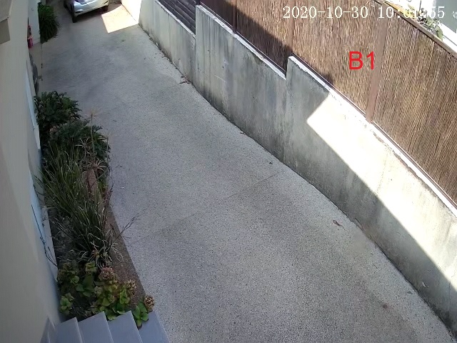

Picture B1 shows camera B during daytime.

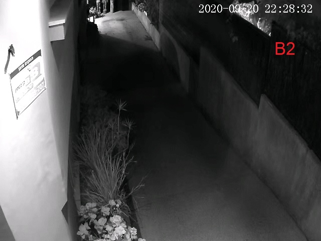

Picture B2 is an older pic, before the change - it's night, but IR pic is clear.

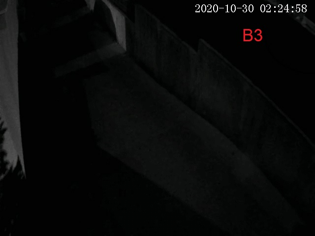

Picture B3 is new - shadows seen on wall but nothing seen from lane. Not enough street light reached it, but IR image not shown. My feeling is as if it thinks there's enough light while in fact there isn't - or that the IR is somehow drowned.

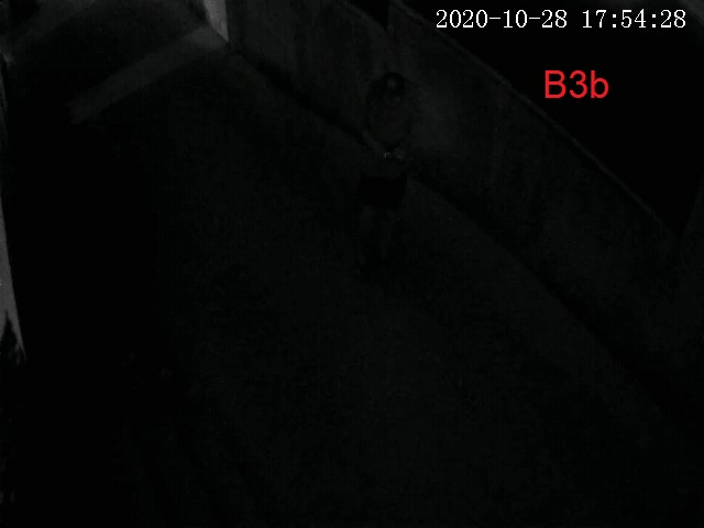

Picture B3b is similar but with camera rotated so it doesn't see any of the brighter wall. I'm standing there - barely noticeable in the pic.

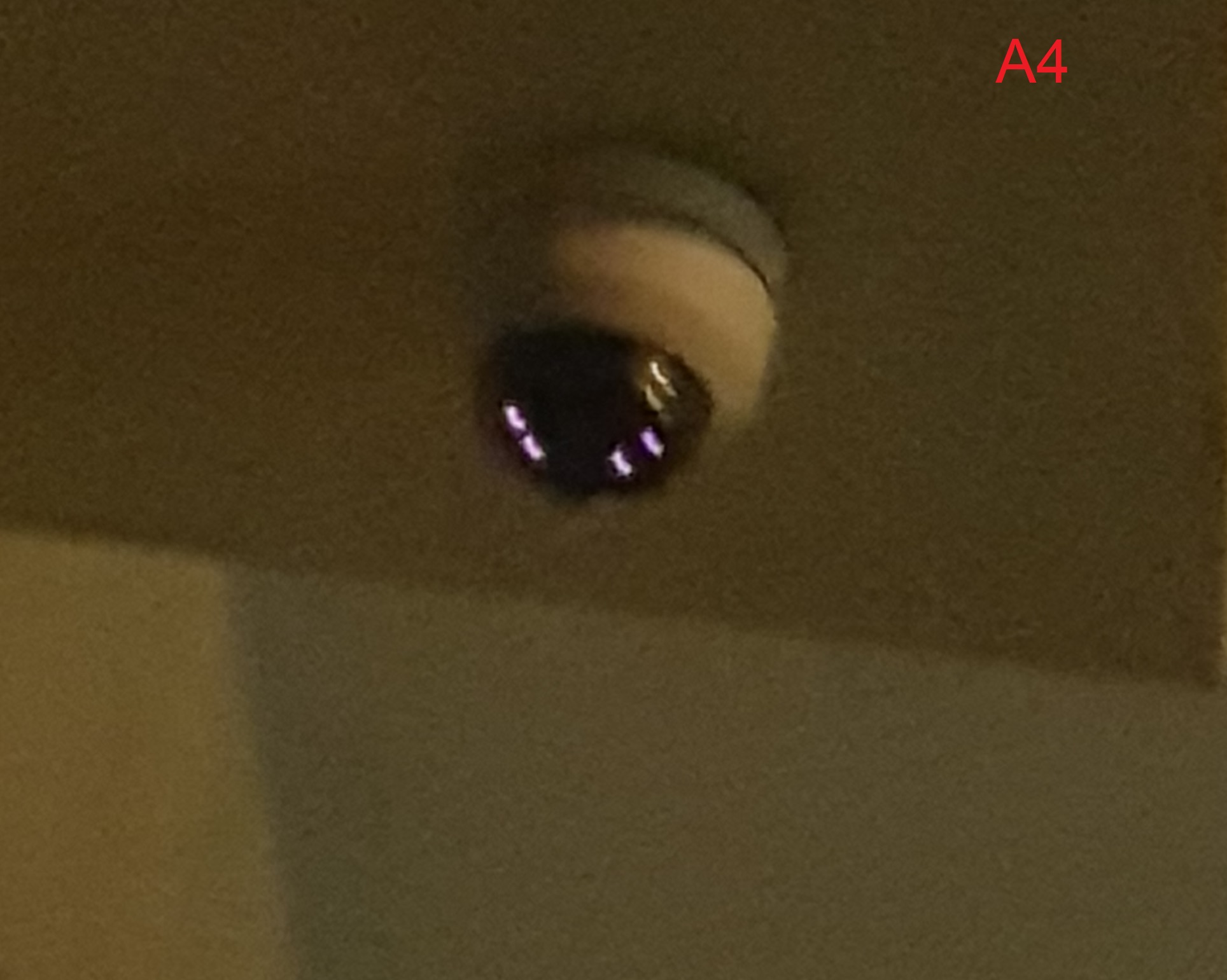

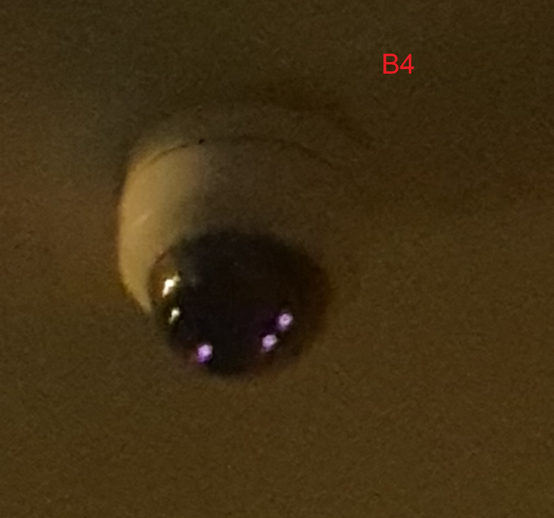

Pictures A4 and B4 show the cameras as shot from my cellphone, trying to determine whether IR is actually on. Note that in both cases there is some reflection from the streetlight on the cameras' domes - but shielding the cameras from direct streetlight did not improve the results.

To check if it is the IR filter you will need to get your ear close to the camera (e.g. either up on a ladder or bring the camera down) and then cycle the camera's power and listen to whether or not you hear an audible click from the camera. The IR cut filter is a physical filter that during the day sits in front of the sensor to filter out the Infrared (IR) light found in sunlight so you get a normal colour image, but at night it moves out of the way to allow the IR light emitted by the camera to be seen by the sensor. If the filter is functioning correctly you should hear a clear click when the camera boots up, if it does not click then the cut filter has likely failed or got stuck and you will have to replace the cameras.
If it does click then the issue is likely that the IR LEDs have weakened, from your images of the camera I can see the pink glow of the IR LEDs so they have not failed but they have likely weakened to a point where they are no longer reaching the areas they use to illuminate.
The one thing you could try is disabling the IR switch entirely by setting the cameras to day-mode all the time and if the scene is not that dark because of the new street lighting you may get a reasonable image at night, but if it is too dark in day mode at night then I think your only option is going to be to replace the cameras.
Wow thanks!
I checked and Camera A is fine (actually, this can be seen in the pic - low nearby plants are lit by IR) but Camera B doesn't click, meaning the IR cut filter doesn't move.
Very logical, as the camera is a couple months old (so IRs shouldn't be weak) but lighting conditions had the camera constantly switching between daytime and IR (when the camera was ok, at certain hours it would go back and forth, and yes - the clicking was heard) so it probably failed.
