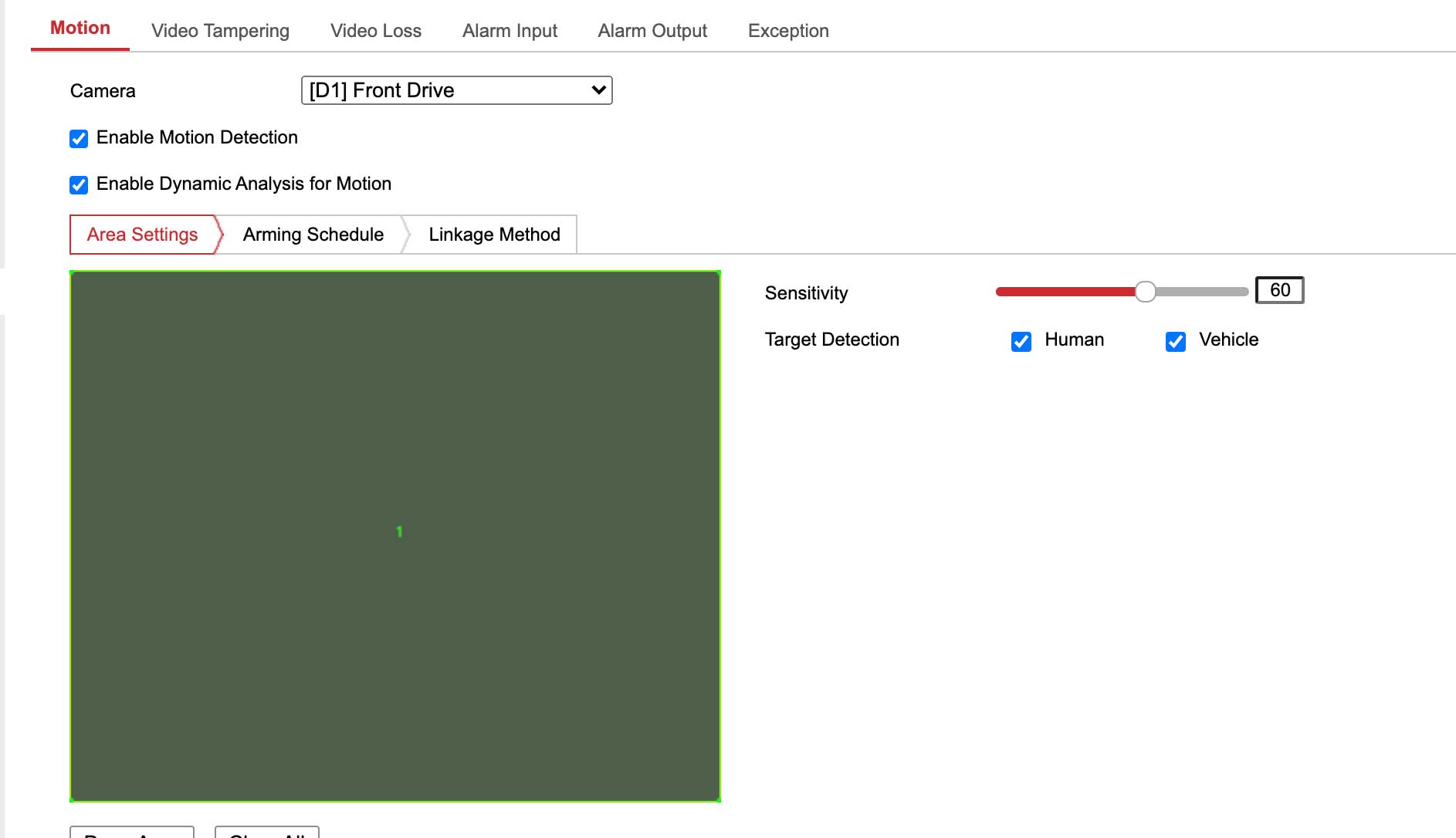

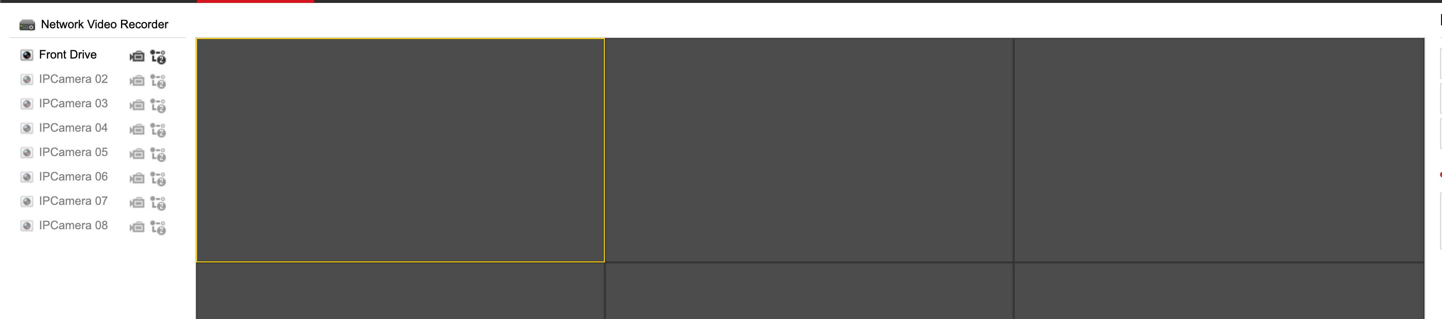

I am trying to create smart events on my cameras but I can't get any live preview when accessing the NVR via IP address. I can see the camera working on the hik connect app.
I have installed IVMS 4200 on my macbook and when I click main view I can see the live view of my camera. When i try and setup events in that application I can't because for example trying line detection there isnt a way to draw a box like you can move the box when connecting to the NVR directly.
My NVR is DS-7608NI-I2/8P
I am connecting to the NVR via IP on google chrome. Have tried firefox and still same issue.
I had this issue recently and it was working previously so I have done a factory restore but still not solved. any ideas greatly welcomed

You were right! i have now logged in but still no live preview on the browser

All cameras (currently only 1 is able to connect) are not showing live preview currently.

The one camera i have working i can now see live preview. thank you.
