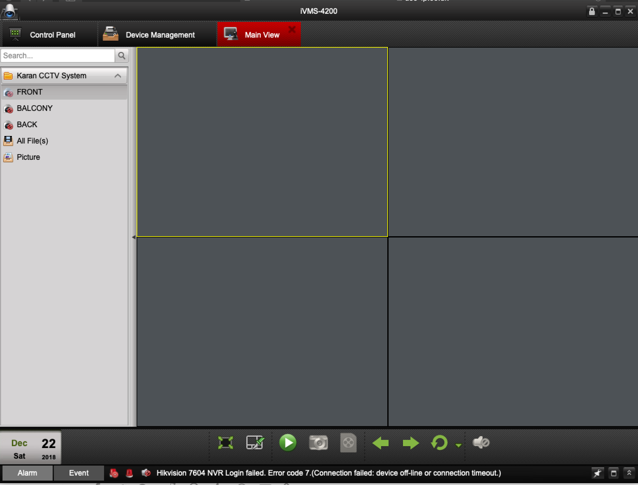

Hi all
I've got a 3 camera set up with a DS7604NI-K1 NVR. I've changed my router from an Asus to a Ubiquiti and connected everything back up.
No longer able to connect to my camera system on iVMS or the web module.
iVMS is showing the device as active when I search for it but says it already exists when I try to add it. However in the camera window, the cameras have red "stop" signs next to them and won't display the feed.
Any suggestions as to how I need to change my configuration to allow this to work again?

Just a quick suggestion.
From the error at the bottom of your screen grab it looks like your NVR is not online. Check in "device management" settings and make sure the ip address, port, subnet mask and gateway are compatible ranges with your new router.

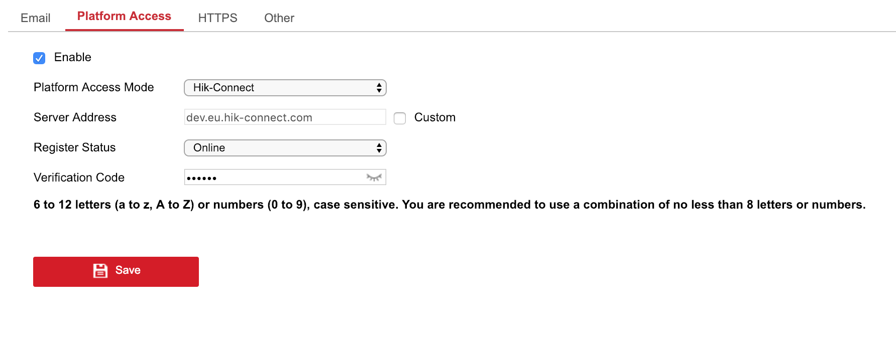

On your Configuration page/ Network / platform access page of your NVR does it say online? as this is where you would setup your NVR for remote access using hik-connect. That way you don't need all the port forwarding or DDNS.
Yes the register status says Online. (screenshot provided)
This was as it was set up with the old router. Haven't changed anything. Still can't see the feed in IVMS.
