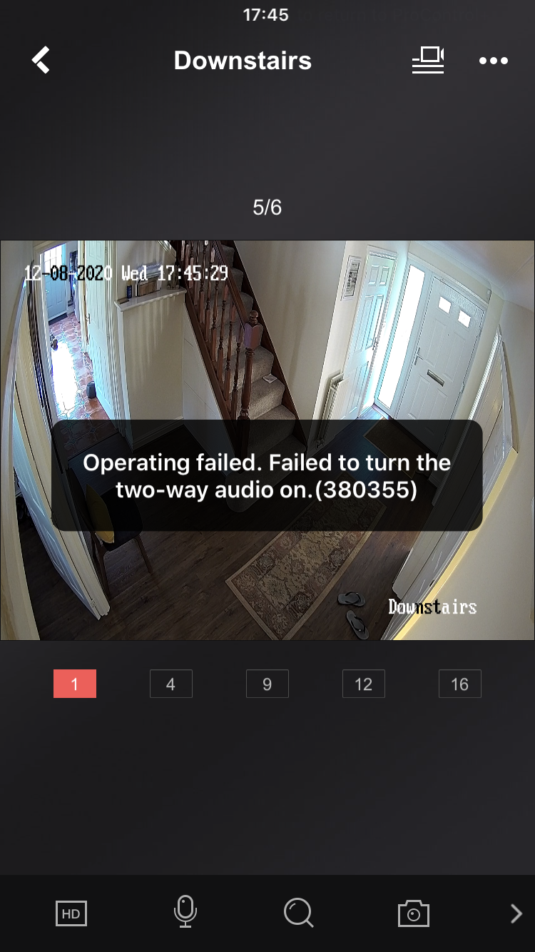

Hi everyone.
Two of the cameras connected to by NVR are Pyronix/HikVision Cube cameras which have built in microphone and speaker for two way audios.
If I connect to them directly via a web interface the two way audio works fine. But if I connect to them via the NVR or via the proconnect app, I get audio but no ability to speak back.
Cameras have setup as Audio and Video within configuration.
Anyone know how to fix this?
I'm getting the same issue on my AcuSense G2 cameras. The screen flashes something really quickly then that fault code appears. I've not got to the bottom of it yet.

Managed to fix this via changing the camera setting on the NVR. Change it to audio and visual in everywhere you see the option. Have mine now working.
