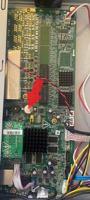

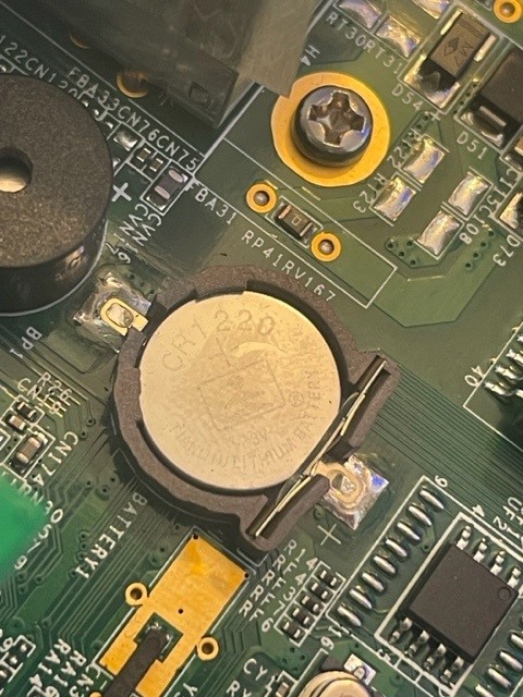

you are right sorry I was wrong, the model I am looking for is the Nvr 7608 NI-I2/8P battery
Hi ste92,
Our demo DS-7608NI-I2/8P uses a CR1220 battery. However, I would recommend confirming this on your own NVR as well, I have attached pictures to show you the battery and its location so you can find it more easily.
