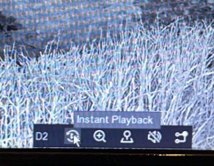

Since I updated the firmware, the whole experience has changed (some would argue for the better), but I seem to be missing the manual record and photo options from the new toolbar which appears when hovering over any camera in Live View.
Previously I used to be able to go to any of my cameras which are set to record only on events (intrusion detection) and manually override it to record or take a photo. Now, the option doesn't exist. I only have the following options available to me: Playback, Digital Zoom, PTZ Control (on PTZ cams only), Audio On/Off, Stream Type (sub, main).
I have attached a screenshot so you can see what I mean. I am logged in as admin, and as far as im aware, I have full rights to everything. When logged in via the Hikvision iPhone App, I can still record and take a photo (to the phone, not the DVR). I do not use Hik-Connect to connect remotely, as I have a static IP and am a network engineer so I don't need it. It worked fine previously on the old firmware.

It's not a function I ever used but you're right it's no longer possible to start a manual recording from the toolbar. I prefer it that way, as for those who are recording on a 24/7 schedule, it worked the other way round and would stop the scheduled recording. It was too easy to do that and I usually removed the "Local Manual Operation" and "Remote: Manual Operation" from a users permissions to prevent it.
My own NVR is an I series so doesn't have the same interface. I did update a family members K2 to that version recently, so I'll take a look when I'm there next. It may still be possible - Hikvision may just have taken that function away from the toolbar and put it elsewhere.

Thanks for this. I found the function quite useful if i was watching something on a camera set to event record and there was no trigger, but was something i would like to capture. Now, im not even sure how i would go about doing it without going into the menus and reconfiguring the recording to manual. What a faff!
Obviously my use-case may be different to others though, and I appreciate that.
It just seems a backward step to remove it completely, as opposed to just perhaps disable it by default but allow you to still turn it on easily. I only wishi could turn it back on.
