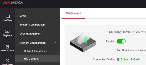

Hi @BuddyLove ...
on the NVR configuration page:
is the connection status showing error "Offline (0xe0020008)"?

This has happened to me 3 times... everyone refers to it as being "blacklisted", but I don't think that's a good description... seems like something just gets "corrupted" in the Hik-Connect sever database when upgrading or downgrading firmware versions on the NVR (more often when downgrading) .... I've found this can be avoided by disconnecting and unbinding the NVR from Hik-Connect before doing a firmware upgrade (or downgrade) and then re-binding and connecting again after the firmware change.
The only way to correct this is to email support@hikvision.com ... include the error code, your NVR serial number, and region in the email... they may reply they need a few more details... reply with any details they request... one time I did have to contact them twice (maybe not all the techs are familiar with the issue) ... If they reply the problem is fixed and you still see the same error just email them again... the 3 times I went thought this process it took anywhere from 12 to 48 hours to get it resolved... the Hikvision techs were prompt and helpful!
