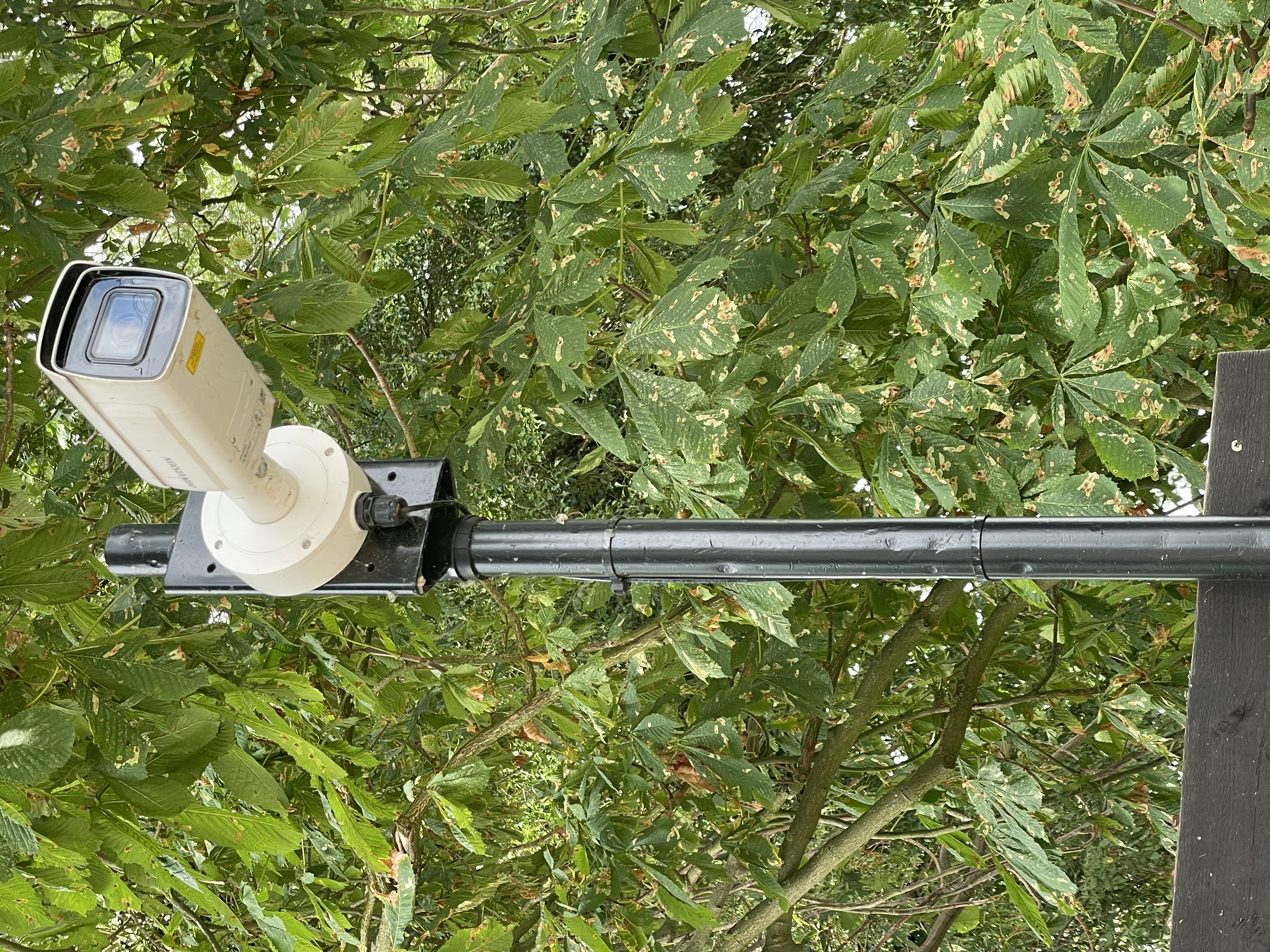

I have a HIKVISION DS-2CD7A26G0 that is missing it’s original white base plate. I purchased this camera about 1.5years ago but never noticed the missing plate until now.
I am trying to install the camera using the Hikvision pole bracket DS-1475ZJ-SUS. I purchased the junction box HIKVISION DS-1280ZJ-S but the holes at the rear of box dont align with the bolt threads on the pole bracket and it’s not compatible with the 2CD7A26G0 camera either.
I’m trying to buy an original base plate for this camera but I’m struggling to find a part number or supplier.
I have attached a screenshot of the original base plate, which as you can see has multiple cut out holes on the rear compared to only four on the normal junction boxes.
I would be very grateful for any advice or information where I can purchase for the original base plate.
Thank you.
Hi @Stevews
Hikvision does not stock replacement junction boxes for the 7A26G0 model because the camera comes supplied with it and none of their other camera models have the same mounting screw layout as the 7A26G0.
Are you sure the 7A26G0 will actually mount to the 1280ZJ-S? The base of the camera is 140mm wide and the junction box is 137mm, it might only be a small difference but it might be enough that the screw holes don't line up.
if the camera does fit, then yes drilling new holes will probably be the only option to connect it to the pole mount. If the camera doesn't fit the junction box, you will have to try installing it on a generic electrical junction box and screwing that to the pole mount.

Hi Dan,
Thanks for your quick response. I was hoping Hikvision had replacement parts for the 7A26G0, which included the original base plate.
After reading your comment about the 7A26G0 using the mount 1280ZJ-S you are absolutely correct, it’s slightly different in size. That wasn’t apparent when I first examined them. I have just tried to connect the two together and the bolts don’t align so that’s no good.
I don’t suppose you would know which generic junction box would be suitable for my needs?
Steve
We don't stock any generic electrical junction boxes, but you can find all kinds of different shapes and sizes from suppliers like CPC or Screwfix

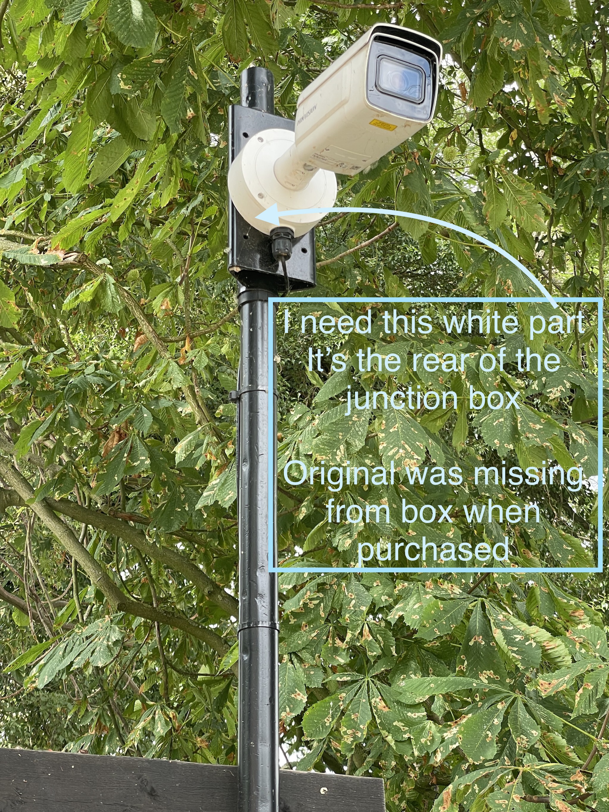

Hi Steve, is that a 7 line ANPR your mounting, but haven’t got the original back plate. So you’re using one from a turret cam?
I fitted an ANPR at mine didn’t order the SUS pole mount, and quickly worked out it was for turret cams. The one I order first was DS-1275ZJ. You may find that fits the back plate.
Hi @R_M
I think there has been some confusion, @Stevews was missing the back box/junction box that comes with the 7A26G0 to mount it to the 1475ZJ-SUS pole mount (which is the correct pole mount according to the camera datasheet).
You can't mount the 7A26G0 to any pole mount without some kind of junction box because the pole mount does not offer any protection for the camera's RJ45 connector and other terminals.
That’s what mine looks like
Hello R_M and Dan,
R_M thanks for the information, however as Dan has pointed out I’m actually after the rear junction box that should have been supplied with the camera.
My camera is the 7 line ANPR version, same as yours I believe.
The part I’m looking for has an arrow pointed to it as shown in your photo that I’ve since modified to demonstrate what I mean.
