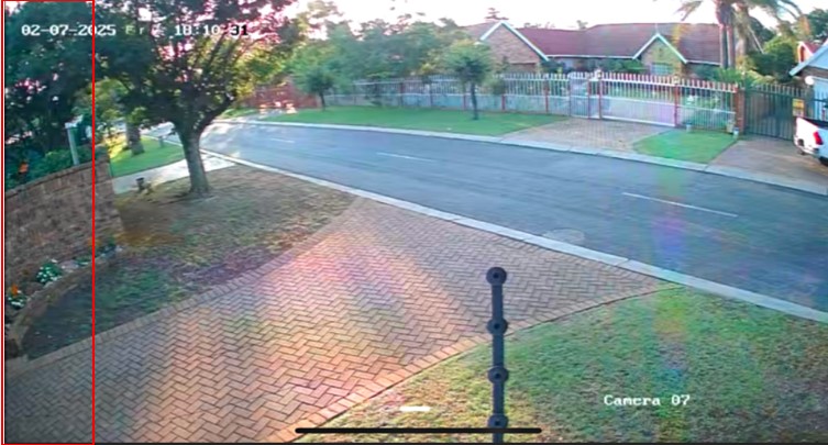

I would like to go with the 3.6mm, but I am worried that with the increased zoom due the reduced viewing angle, I will loose to much of my viewing angle.As your best guess, do you think I will loose more viewing area than what is marked in red on the image? Happy to sacrafice the "wall view" as I have another camera covering that drive way, but do not want to loose any larger section of the image.
3.6mm is still wide angle. Hold your hand out with your fingers and thumbs spread and you can approximate a 90 degree horizontal field of view at the cameras location. Look at how many degrees horizontal you'll get for the 2.8 and 3.6 on the data sheet - both are over 90 degrees from memory. The wider the angle of view, the more image distortion you'll get (curved horizontals), objects will appear smaller in the view. I personally never use 2.8mm unless what I'm trying to cover is right in front of the camera and I'm unable to move the camera further back.
