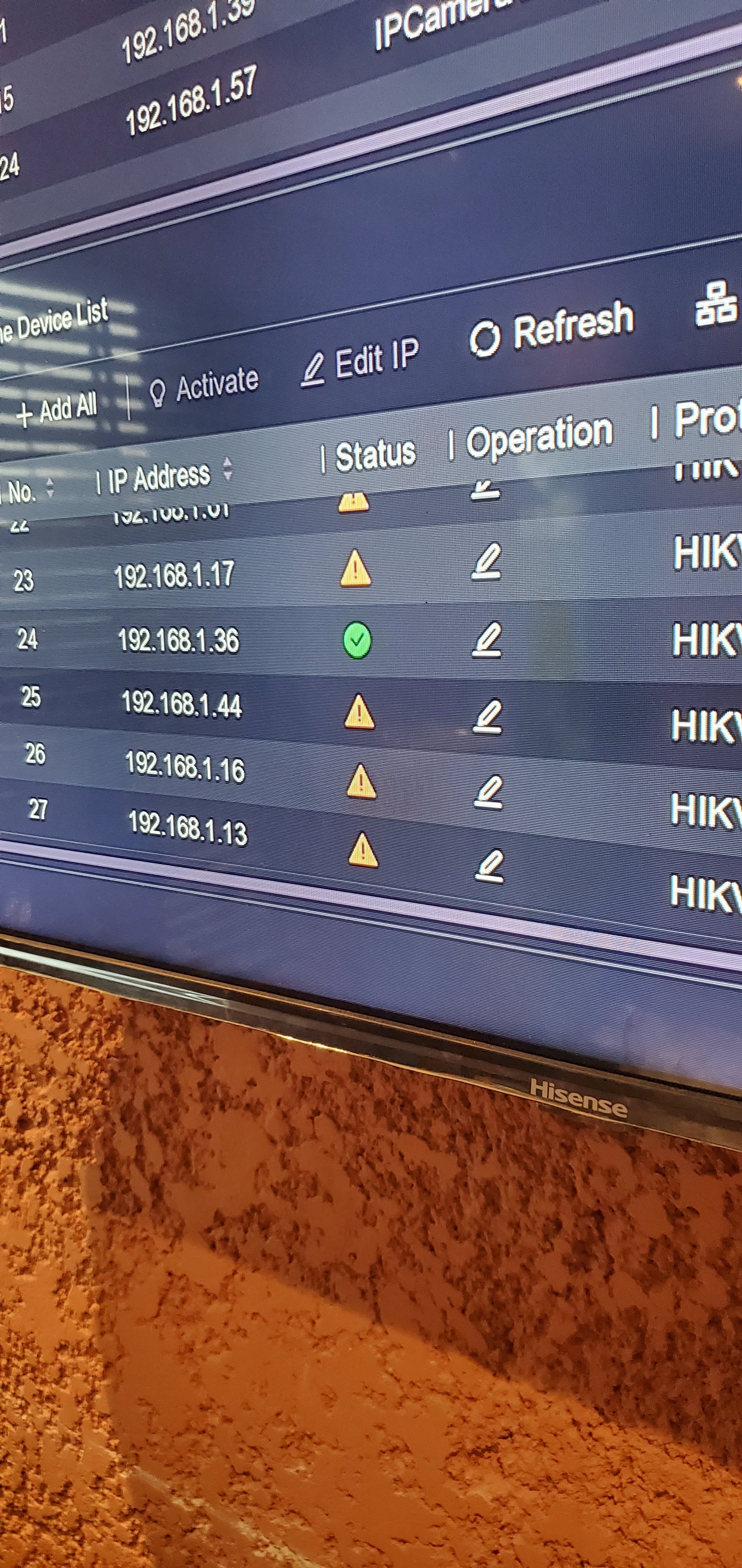

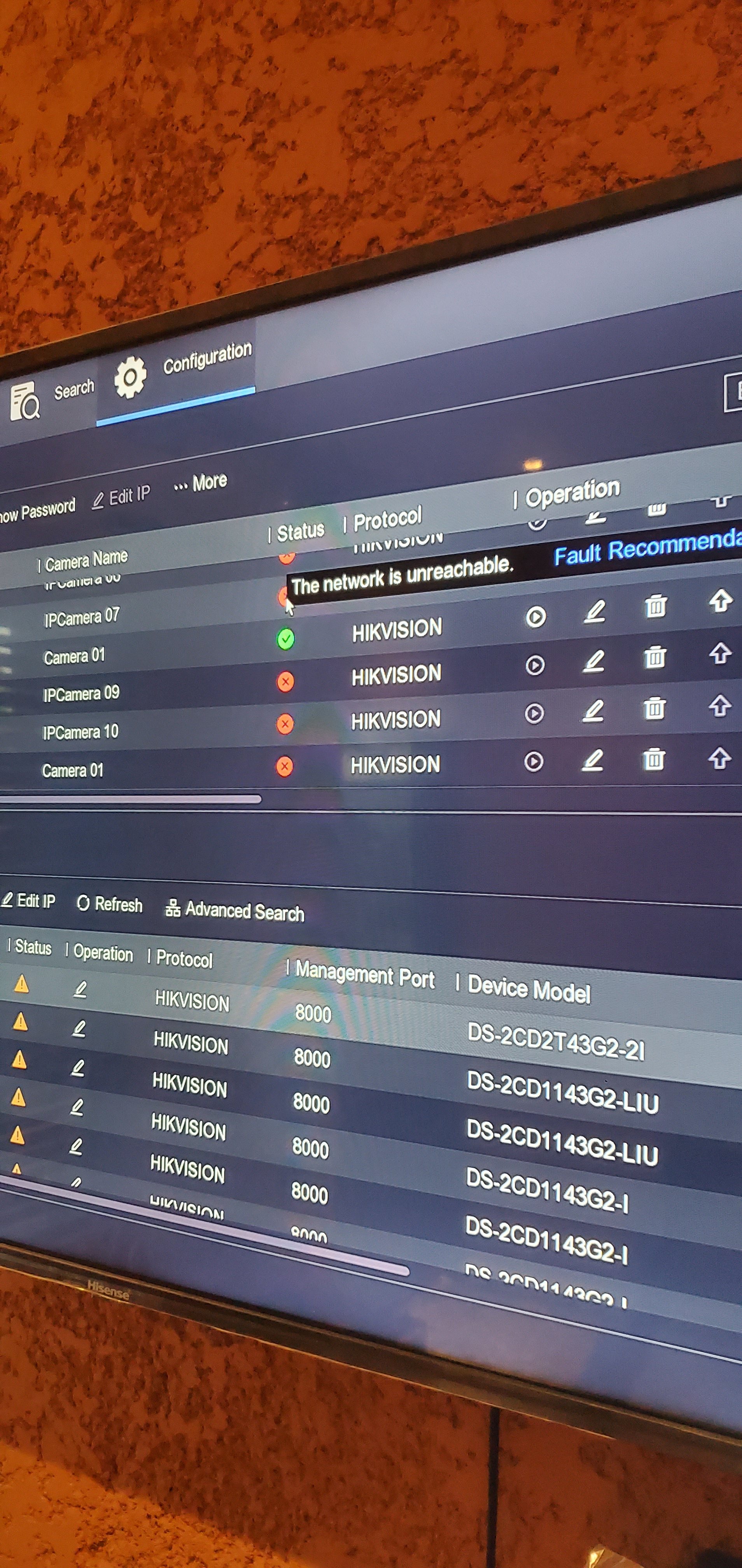

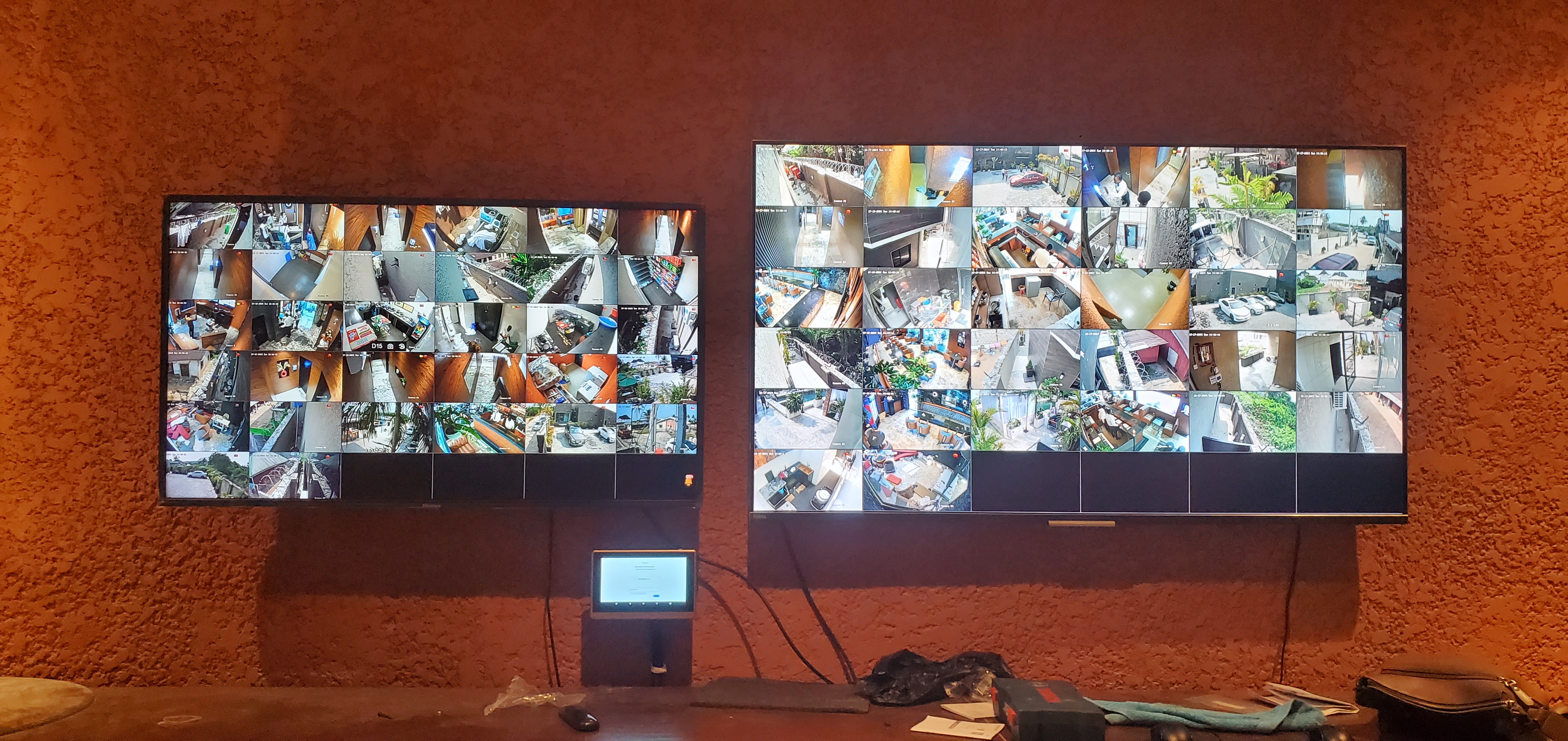

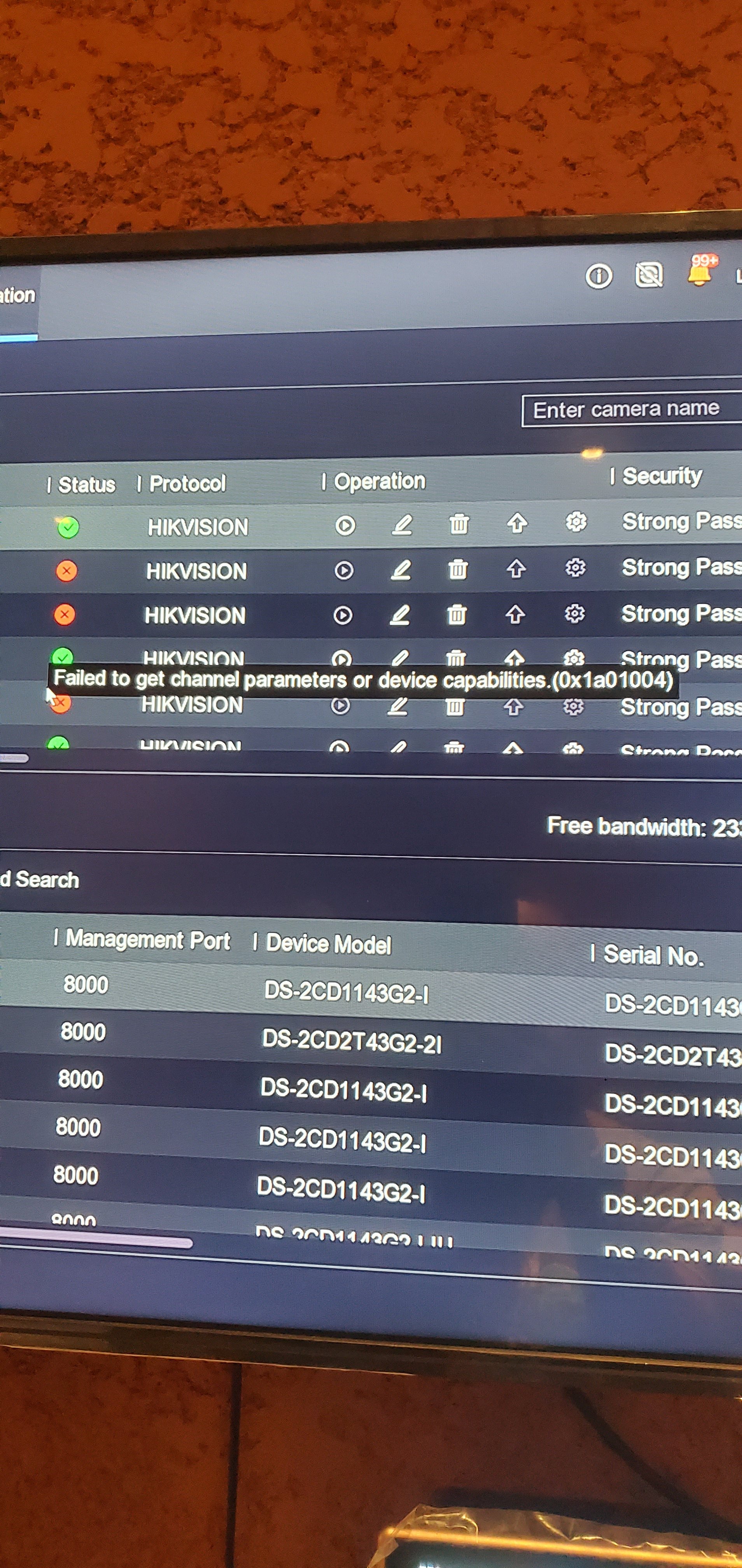

No, I didn't connect a router to it, but now I've been able to access the cameras on my laptop with the SADP tool and manually assigned IPs to all the cameras with their gateway. The issue I'm having now is, one of the NVR's are showing all 32 cameras very well, but the other NVR shows online cameras (and still shows the other cams that are connected to the other NVR but with a caution ⚠️ that these ones are connected to another device) but when I add the online camera to the NVR it all shows that they are unreachable.
The first picture shows the cams being online,
The second one shows the other cams that is added to the other NVR with a caution ⚠️ sign, the third one, is how it turns out after I add them to the second NVR, some show THE NETWORK IS UNREACHABLE, while some show FAILED TO GET CHANNEL PARAMETERS OR DEVICE CAPABILITIES (0x1a01004).

I'm not sure what model Hikvision NVR you have. Is the NVR automatically adding the other cameras it sees on the network? If so you should be able to disable that function. Have you tried manually adding the cameras?
David
@kizzy9c
Like an orchestra performs better with a conductor an IT network is better with a router. I think you'll regret not using one.
David
Thank you David , I'll have that in mind.

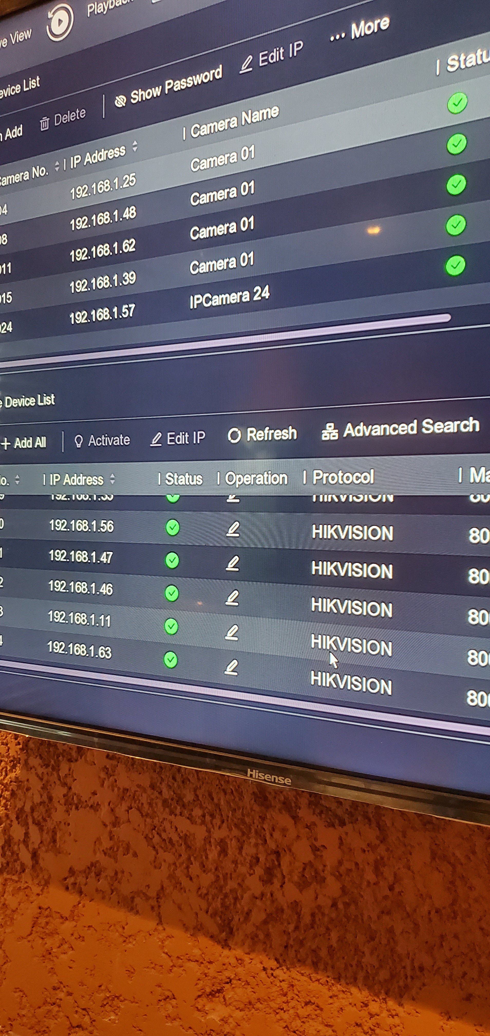

I disabled the Plug and Play functions and added manually but still get the same report. I had to try another method by plugging some of the cameras into the 16 PoE ports of one of the NVR's and those ones came up then I added the other ones manually now they are all up . I wanted to load them all with PoE switchs so I turned off their PoE ports but the issue came up. Thank you very much David for your support and time, I really appreciate you.
