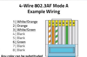

Perhaps the camera does not support PoE this way. But understand standard 802.3AF which does not use 4 and 5 pin for + and - nor 7 and 8
It uses orange and green pair to transfer network + power
