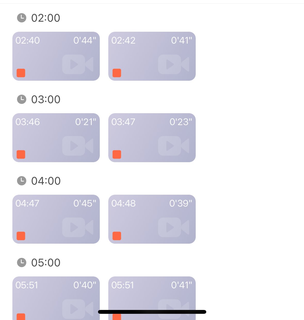

The camera has been installed for several years.
Recently, I installed an owl box at the back of my garden.
This phenomenon has been happening since i put the owl box. According to the recordings, it occurs once every hour.
Thanks a lot
Excuse my english, i'm french ;)

Thanks @pucccin0
Does the camera automatically patrol multiple positions or is always fixed on the owl box?
If it is fixed on the owl box all night, have you tried temporarily moving the camera to look at something else for one evening to see if this happens whatever the camera is looking at?
I'm just wondering if the camera's IR reflecting off the box could be causing some kind of strain/issue for the camera's sensor that means it is having to readjust itself every hour to stop the sensor from being damaged.
