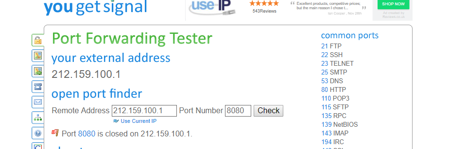

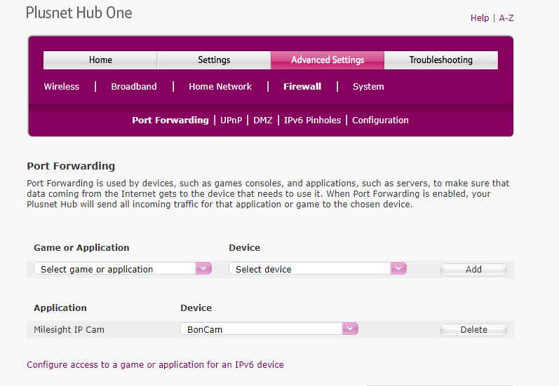

Does the router accept the configuration change when you forward the ports?
it seems to. But when I try any port checking websites it says they're all closed.

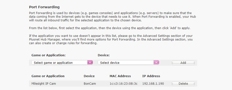

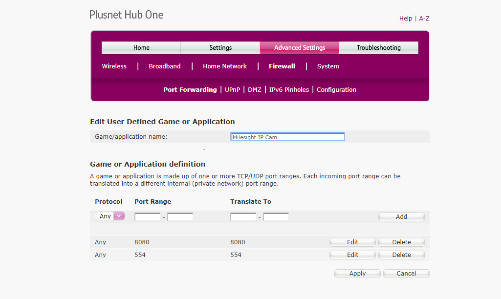

Ok. Where is the bit where you forward those ports to the actual device?

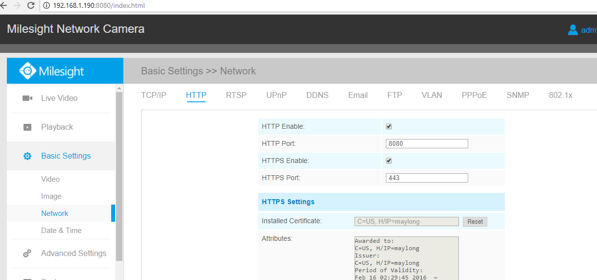

Assuming the internal IP is correct, that does look like it should work. Have you verified this works from within your network? Can you access http://192.168.1.190:8080 (presumably the web interface)? If that works, can you verify the gateway address that's set on the camera is correct.

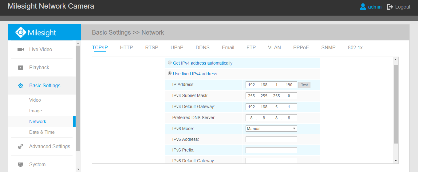

Yes, I've no problem accessing the camera. Here are the settings.
You didn’t update the default gateway. It’s still set as it left the factory. Give it the address of your router.
