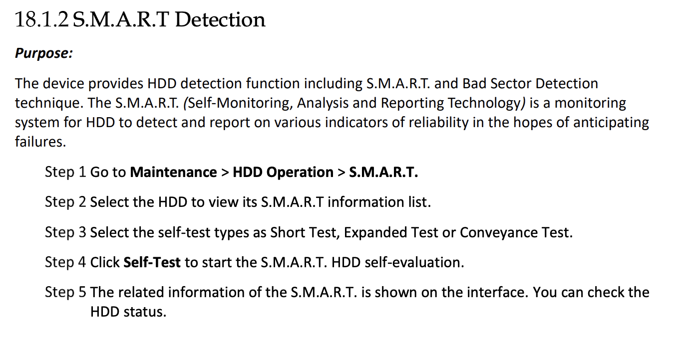

Based on what you described in your previous post (no video found, disk exception, etc...), it sounds like your HDD could be faulty.
If you follow the steps in the screenshot below from the DVR user manual, you can run a S.M.A.R.T test on the HDD to check for any faults.
If you run the Short Test and it fails, this more than likely means you have a faulty/failed HDD and will need to replace it.
If the HDD is only a couple of years old it might still be in warranty, you would need to check this with whoever you bought the HDD from.
Thank you
I have followed this and done the short test and it said the test succeeded...

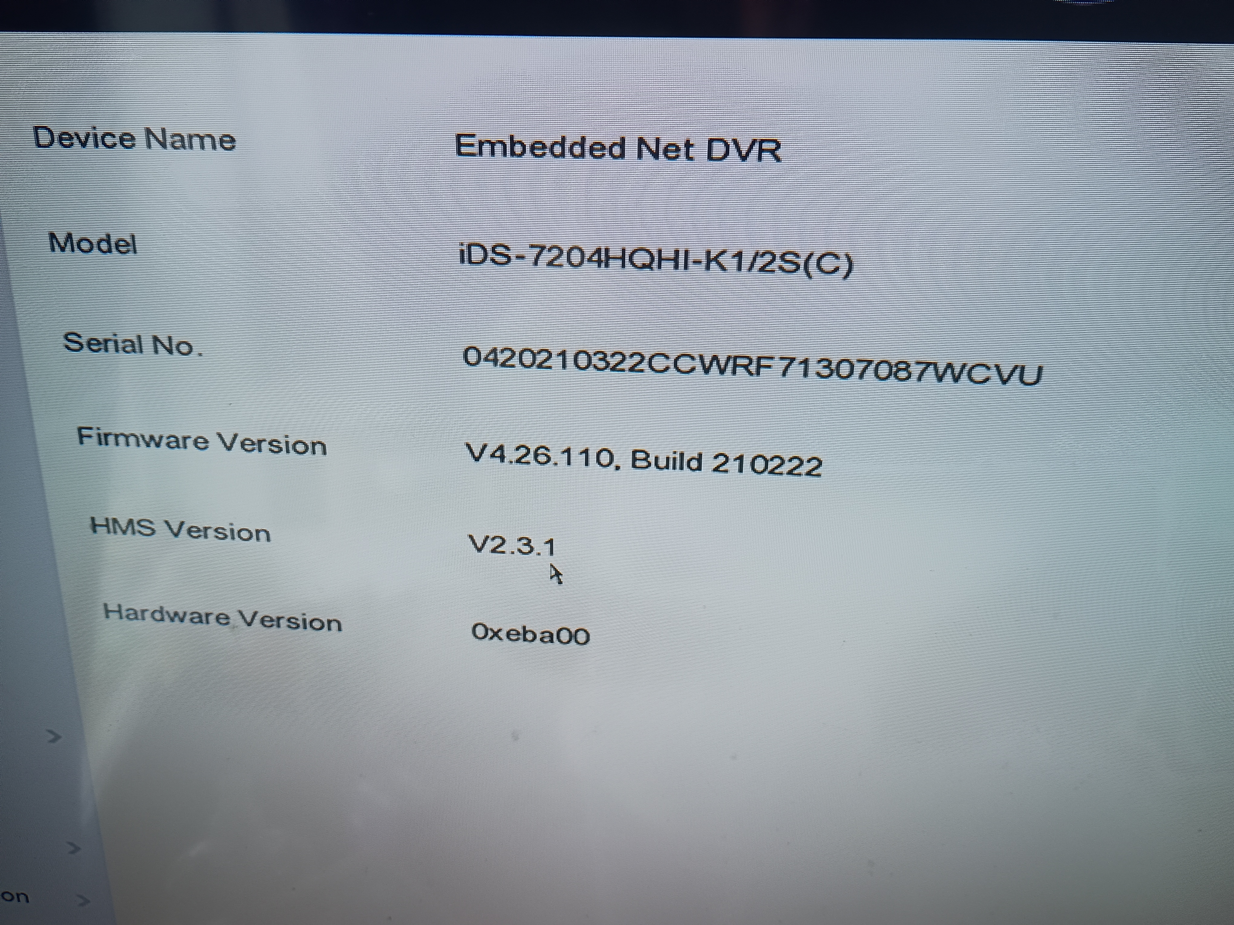

Can you please confirm what firmware version the DVR is currently using?
I'm sorry for the stupid question but I'm not sure what you mean by this or how I find this out?
Hi @Popps
When you log in to the DVR and go to the System > Basic Information menu, you should see the current firmware version that the DVR is using.
If you are running old firmware, this could be the cause of the strange behaviour/glitches you are seeing.
It says this
Oh ok
Is that something you can do yourself or do I have to get someone in for that?
