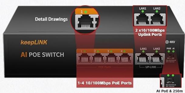

Hi, Keeplink poe switch

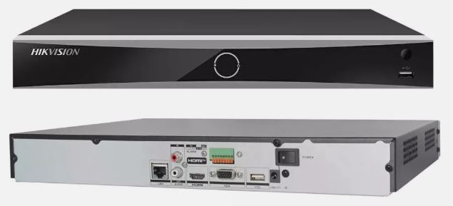

& the dpv Hikvision DS-7616NXI-K2 12MP 4K AcuSense 16 CH

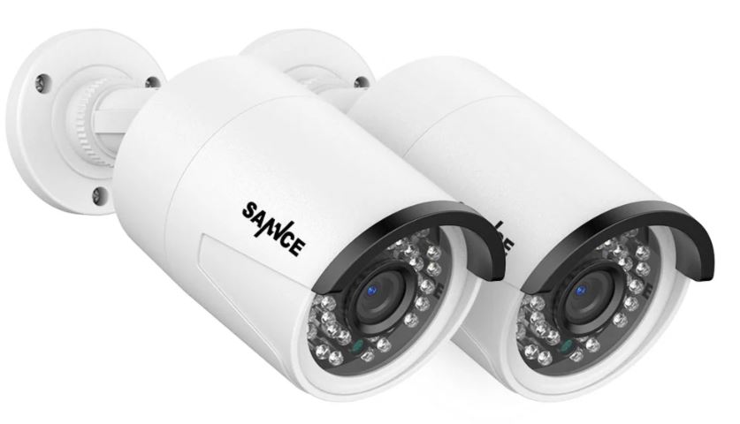

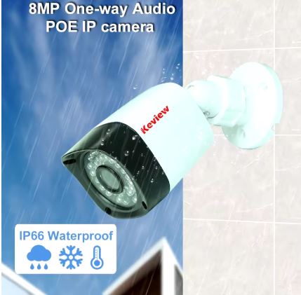

What are the model numbers of the cameras you currently have connected to these PoE switches? Both the original cheap Chinese cameras and the single Hikvision camera.
Thanks @collectors
Unfortunately, those product pages are not all that helpful as they don't have full specs stating the power usage of these camera models (this is very common with cheap cameras) but from the looks of them I wouldn't expect either of them to use more than standard PoE (15.4W) so they shouldn't be exceeding the 65W PoE budget of your switches.

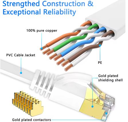

Hi, going to have a go at your suggestions of unplugging all & introducing the cameras back in one by one. I am waiting for some emails to find out the load on each camera. I did find out the switches are 120 watt "Total" each. There are also TV's & laptops plugged into the switches, but i assume they provide there own power & rely on the switch for just data. I did also upgrade many of the cables to cat6 & didn't know if this might effect things as the cables seemed thin & more like a ribbon style cable. . ??
