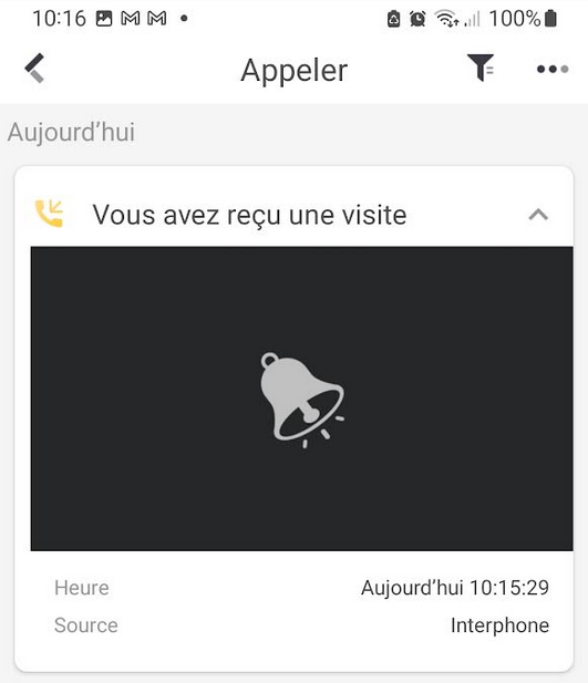

  • If no one answers, I do have a snapshot of the person who pressed the button on the tablet. => OK
BUT ! Because there is a but... On hik-connect, I have a gray bell instead of the caller snapshot.
For those who have a Hik-Vision IP visiophone, when you missed a call, do you have the screenshot of the caller or do you have a gray bell?
Thanks a lot for your help.
Cédric

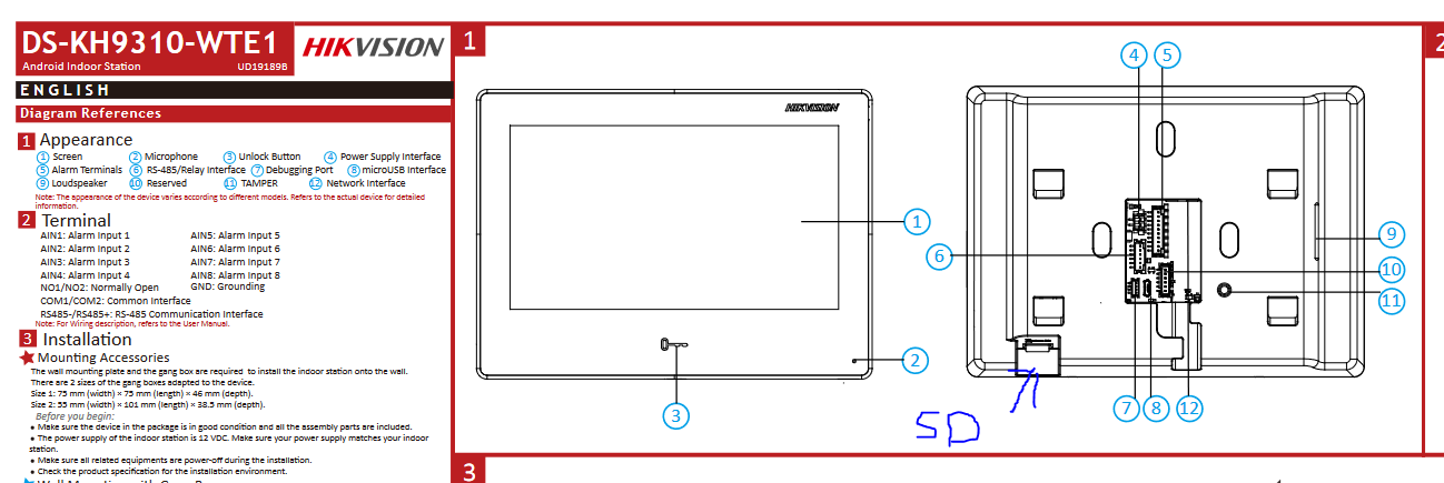

First of all, I will apologize to you because there is indeed an SD card slot! I discovered it by accident...
But in the datasheet or in the docs they don't refer to it (cf. image).
So I put a 16 GB SD card but android asks me if I want to extend the existing os or if I want to make it an external storage.... Still can't find the info...

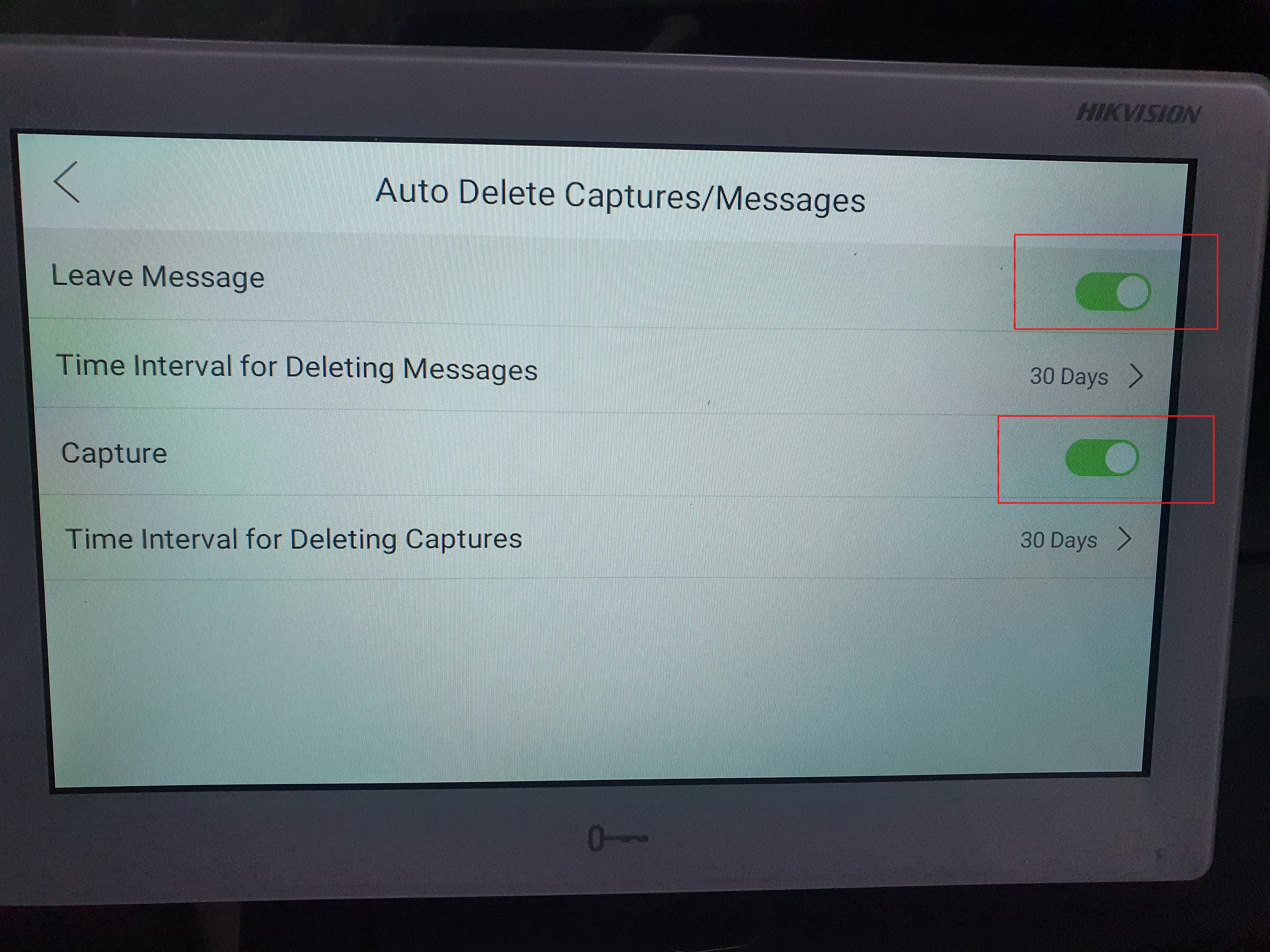

I just reseted everything one more time. Rebooted a few more times, and toggled that "capture" setting, and for the first time I saw a snapshot on hikconnect.

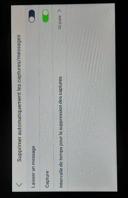

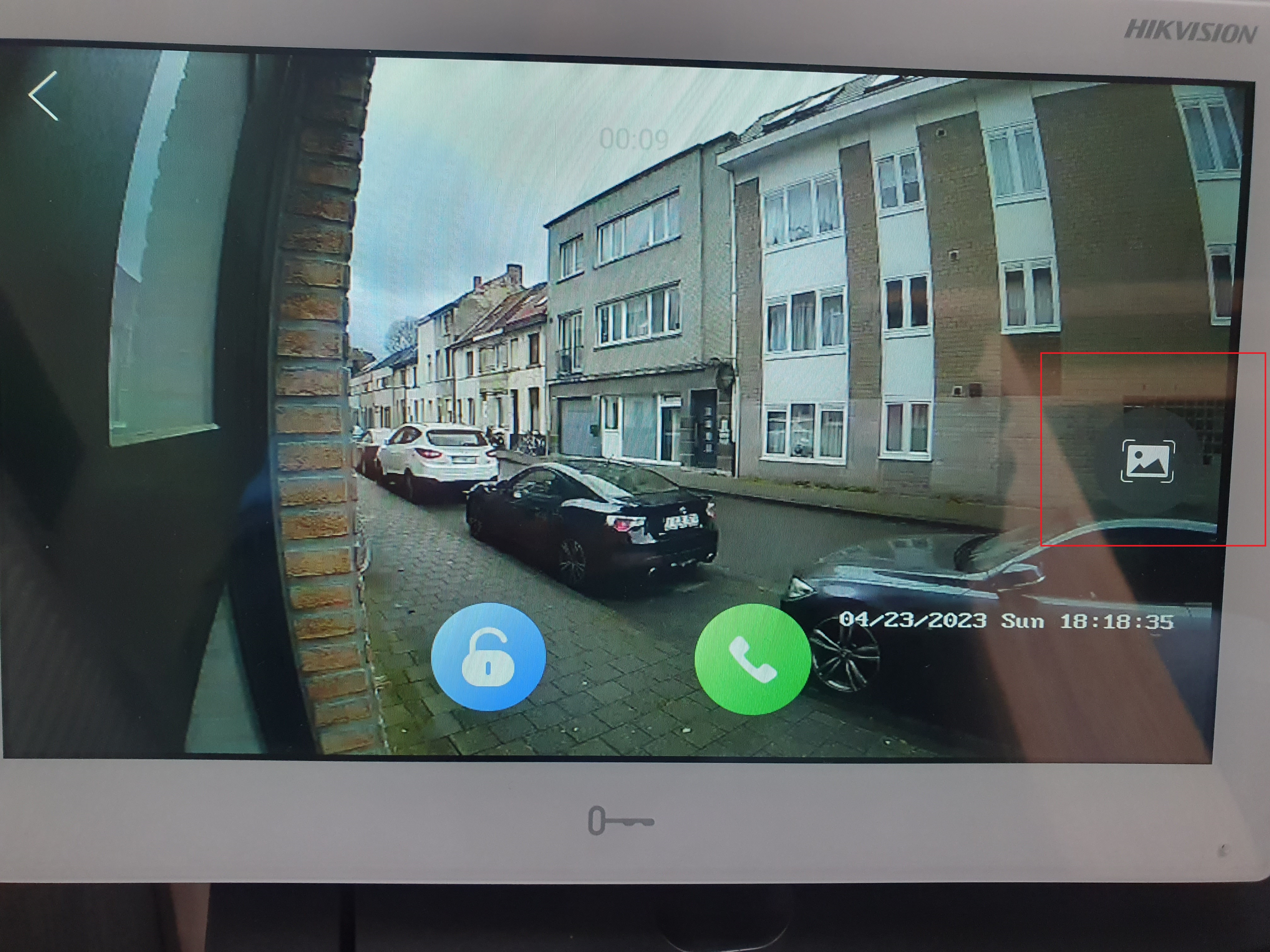

As a result of long efforts, I found such a solution.
if you make these active photo 1
*You can get a snapshot at the time of the call (photo 2)
*you can see pictures in call history / photo 3 (including sound recording, not recording video)
