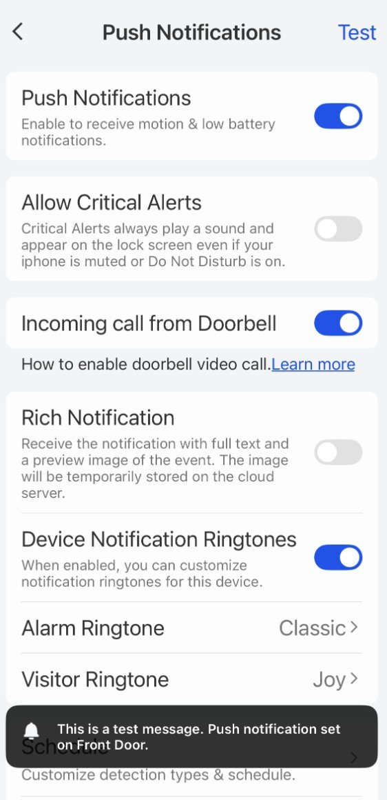

The issue appears to be with push notifications. The doorbells appear to operate as normal when connected to the LAN at home ie door Chimes (iPhone is on the same subnet as the doorbells) but when the user is away from the property, push notifications from the doorbell are not pushing to the iPhone (for example, when using 5G data).

  3. Ensured push notifications are turned on in the iPhone Reolink app

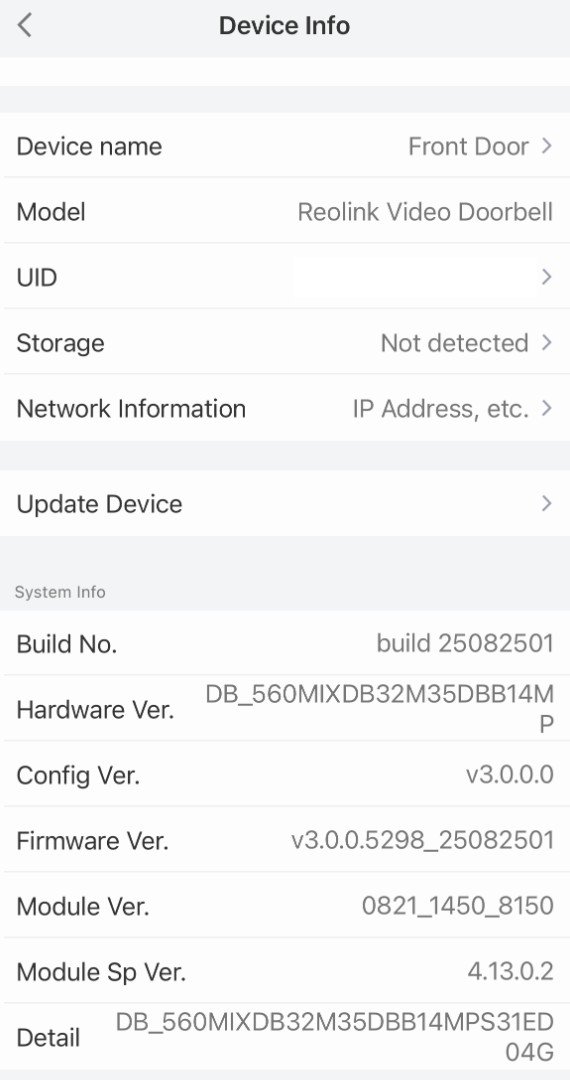

Build number of doorbell: 25082501
Hardware ver: DB_560MIXDB32M35DBB14M
Config: v3.0.0.0
Firmware: v3.0.0.5298_25082501
Module: 0821_1450_8150
Detail: DB_560MIXDB32M35DBB14MPS31ED04G
