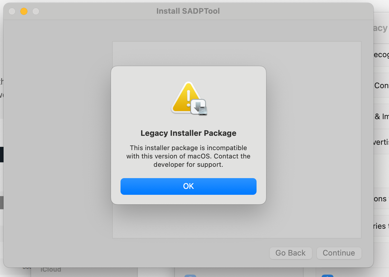

Hi. I'm having difficulty using SADP TOOL on my mac. The downloads don't work, does anyone have a solution? I'm on macOS Sequoia 15.1.1. Thanks.

As far as we are aware, several of the Hikvision Mac Tools are no longer supported by Macs running MacOS Sonama or newer.
Hmm - that's a pain. I've just tried mine on MacBook running MacOS 15.3. As it was installed under an earlier version, the app starts but after a refresh does not see any devices. I also have Windows 11 running on the same MacBook in a Parallels VM and that works fine. I'll not hold much hope of seeing an updated SADP for Mac anytime soon from Hivision.
You might be better just registering for Hik-Partner Pro for your mobile device which has SADP built in. Theres also Hi Tools Delivery but I'm not aware of a Mac version
