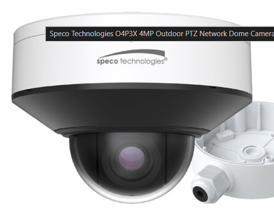

Speco - O4P3X 4MP 0 to 67° tilt range
Is there a standard way manufacturers specify these, meaning that 90 is vertically down?
The Speco for example: if it were to go to 0 then it looks like the lens would be half occluded, and 67 means it cannot look down? Seems they are using the opposite meaning.
