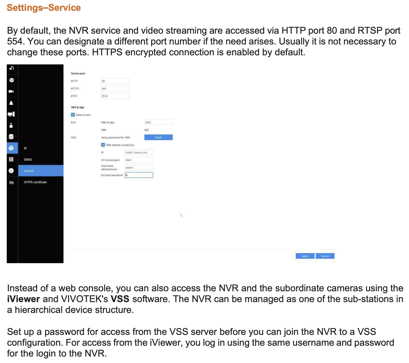

4) In regards to setting up remote app access, see the below information from the NVR user manual:
