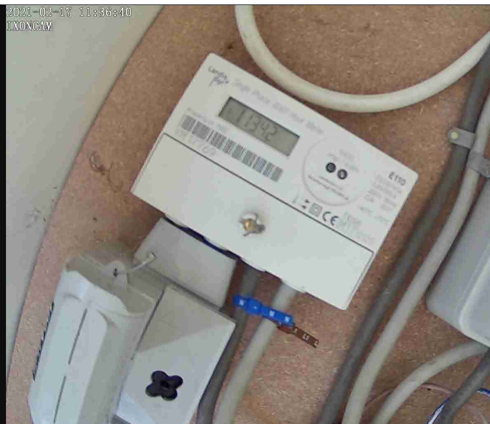

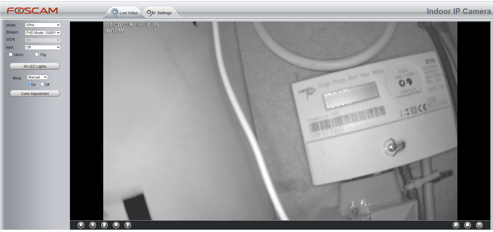

I have attached 2 screen grabs of the Foscam in the light and dark for reference.
It would be good to have a couple of options available.
Thanks again
JT

Thanks for sharing the screenshots - those make the problem very clear.
It'll be interesting to see how you get on,
thanks.

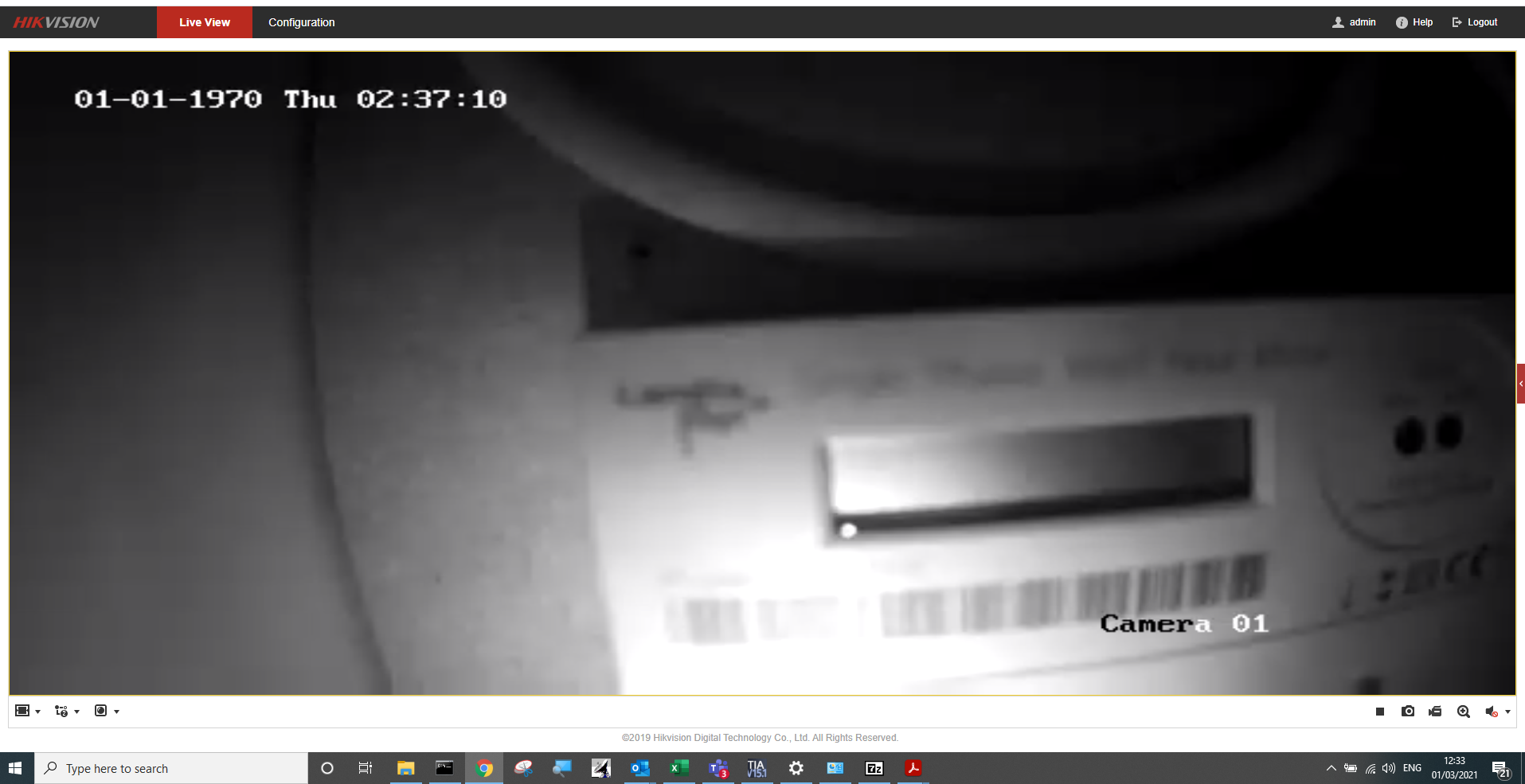

Update: I have got a Hikvision Cube and although there does seem to be quite a few settings for the lighting, I am still getting a blank display coming through.
Would anyone have recommendations to the type of changes I should make to the lighting settings?
See attached for reference.
Thanks
