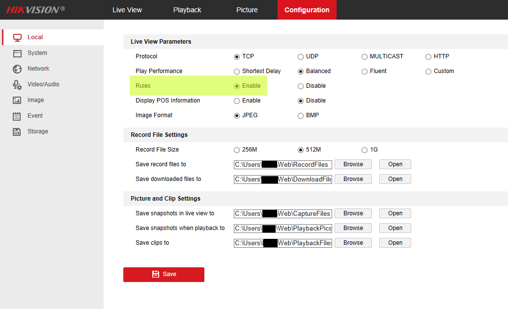

I've got a DS-2CD2347G2-LU 4MP ColorVu which I'm very happy with. But I have an issue with the line detection smart event and I don't know how to fix it. My issue is that I have it set up at the end of my drive. If someone comes in from the left side it triggers, if they come in the middle then it triggers but if they come in from the right hand side, they can walk onto the drive with no alert. It get's them on the way out though. But I'd like to fix this little niggle.
I've got a Max size setting box of 9.5% and the line is set for both directions detection with humans and vehicles as targets. Target validity is set to basic and sensitivity is 70%.
I've attached some videos to show the issue. I suspect it has something to do with the hedge I have on the right side of my drive but I'm just guessing. If anyone has any suggestions I'd be most appreciative.
