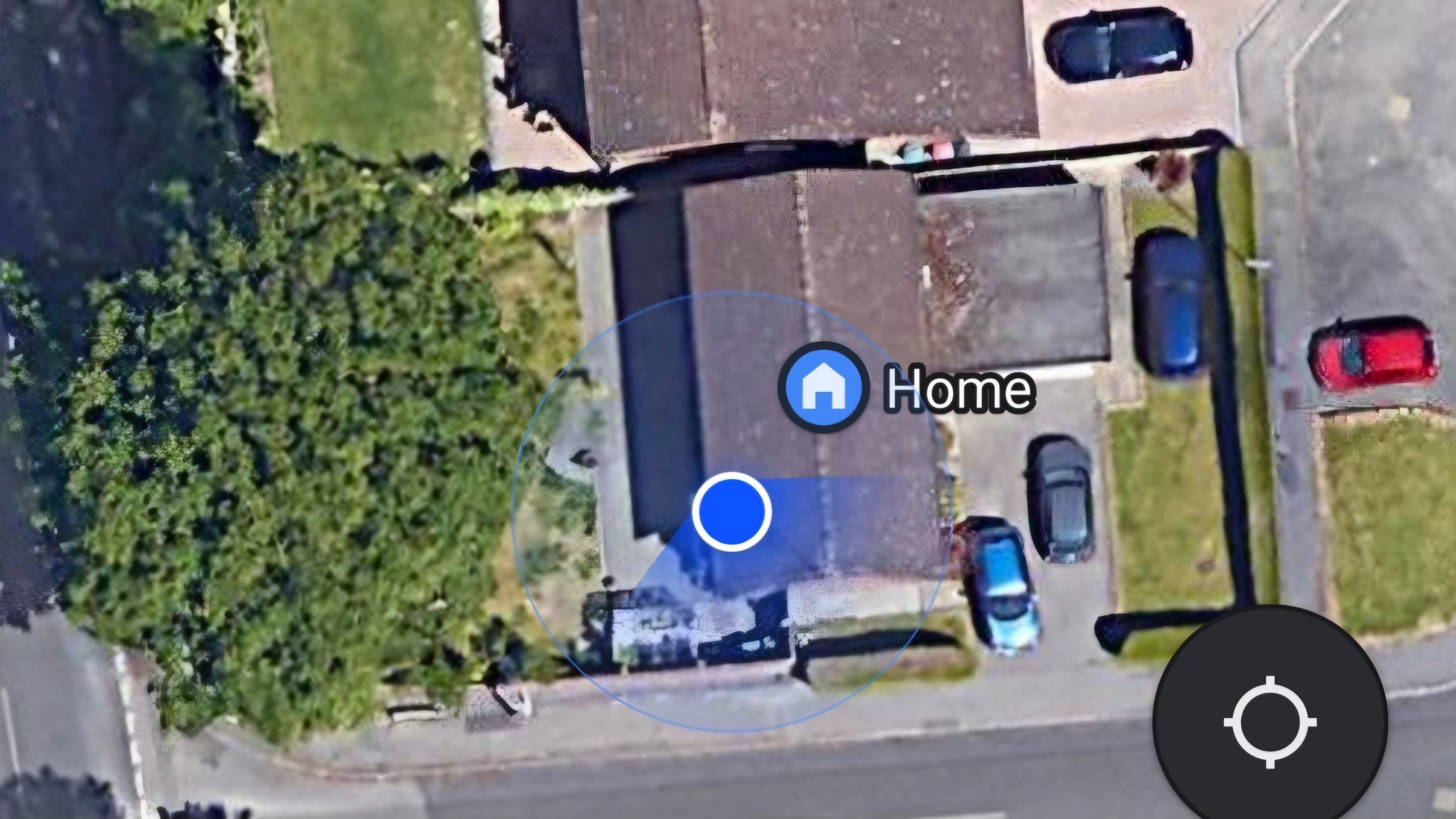

I'm attaching a sat view of the property to give an idea of the area to be CCTV'd
