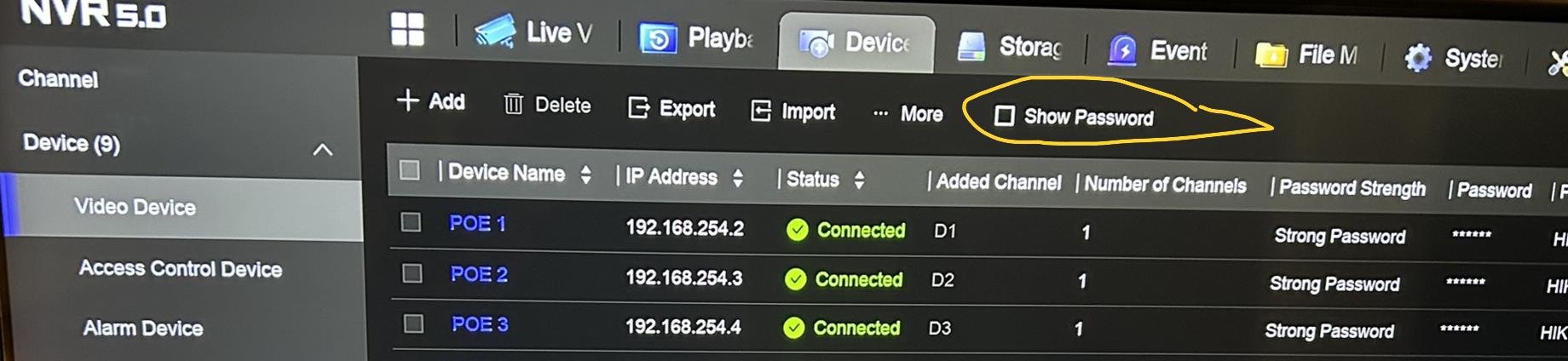

I never tried, but if you plug an activated (random password already set) camera into the NVR, the "Show Password" function wouldn't work I suppose? :(

Normally the password is the same as the NVR admin password which they will have (otherwise they will have issues themselves)
