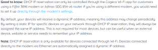

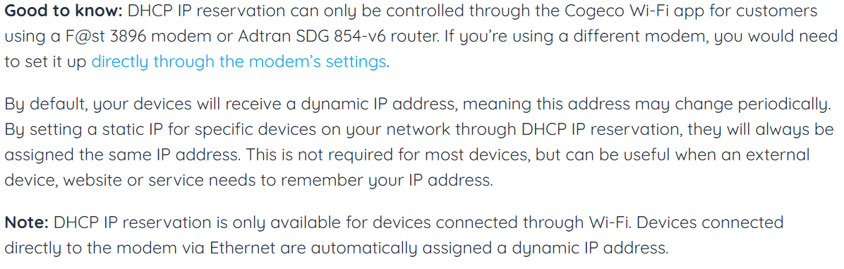

The router model is an Adtran SDG 854-6. The router is only configurable through the "Wi-FI App" provided by the ISP. I was just reading that only devices connected by WIFI can use IP Reservation. There is no access to any settings in the browser interface. I think we need a new router.

In the "WIFI App" for the router shows the IP's for the NVR's and only 172.16.0.2 for the cameras are reserved, but according to the ISP's website, since they are connected by ethernet the reservation doesn't work? Only devices on WIFI can do IP Reservation. And like I said, there's two cameras and a printer with the same IP and no reservation for that IP.
looking at the router manual default web gui access is possible via ethernet or wifi, yours could be disabled. Also looks like default DHCP IP reservations are on the LAN for ethernet and wifi interfaces. double check on your router.
