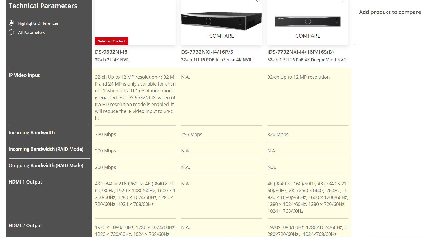

However what I'm not sure about is: when you look at the attached photo- the 9632 series doesn't seem to have any of the: facial detection and analytics, face picture library, face picture comparison, human/ vehicle analysis. Next to this series it says N/A- is it just not listed or does the 9632 series not have any of those features?
So what are the main advantages of the iDS-7732 series? I see it's deepinmind NVR- what is that good about it? And which one would you choose and why? I'd love your advice on this one. ( just a side note- what does the nxi stand for? )

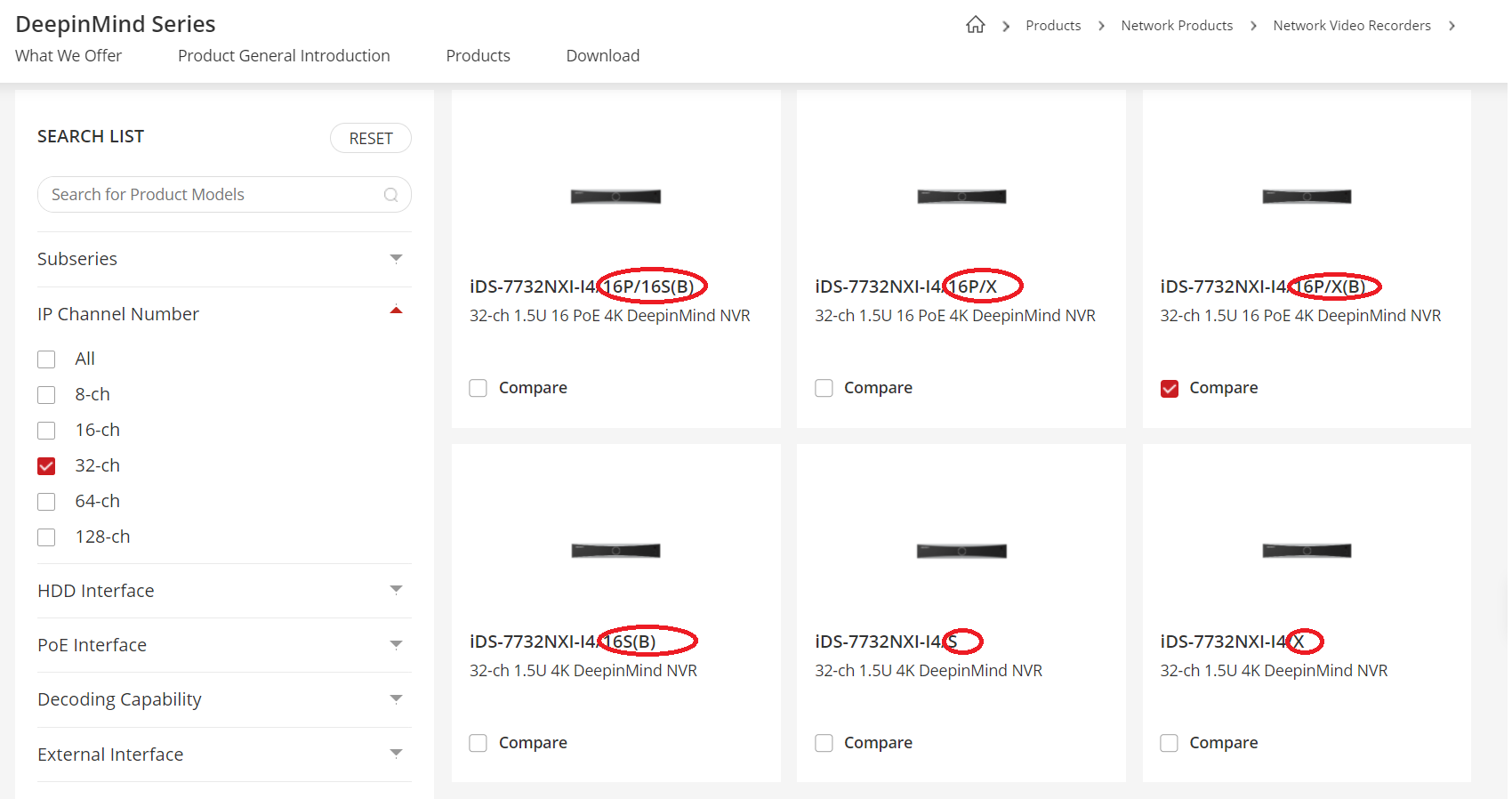

And on other picture attached there are various different models in the iDS-7732nxi series? Loads of different / and / numbers.

In regards to the NVR, if you are not using DeepinView cameras then there is little point going for the DeepinMind NVR as the majority of the advanced features it supports are only included/supported by those top-spec DeepinView cameras, the AcuSense NVR only really makes sense if you have some legacy cameras that are non-AcuSense as these NVRs can apply AcuSense features to a limited number of non-AcuSense cameras. In your case, as it is a new system with mainly AcuSense cameras I think the 9632 NVR would be fine. (or if you don't need the 8 HDD bays you could go with the DS-7732NI-I4/16P model as well)
