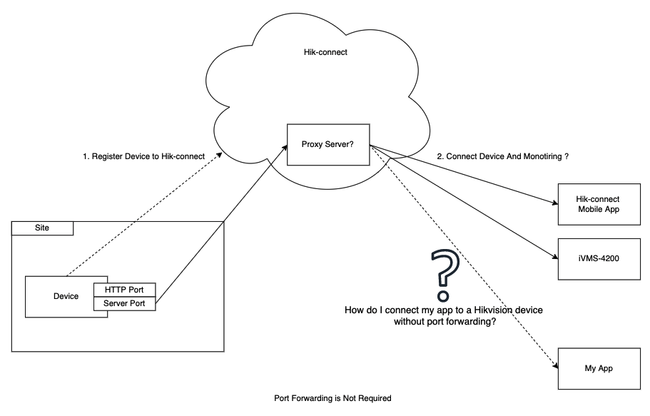

On the other hand, Hik-connect App (Mobile) or iVMS-4200 seems to be able to connect to devices registered in Hik-connect. Without port forwarding. The figure below is what I guessed on how it works without port forwarding.
I guessed that if my Hikvision Devices are registered in Hik-connect, I would be able to connect without port forwarding in my App as well.
