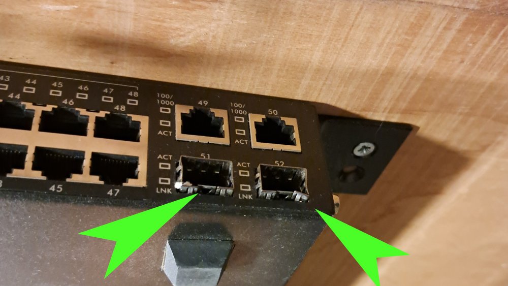

Different topic, in the image below, what are these two 'sockets' for on the back of my router please? They're quite deep (far deeper than the RJ45 sockets).

SFP slots in switches allow you to add, for instance, fast/fibre connections to more switches and devices.

Those are SFP slots - see Wikipedia for more than you ever wanted to know about them :)
