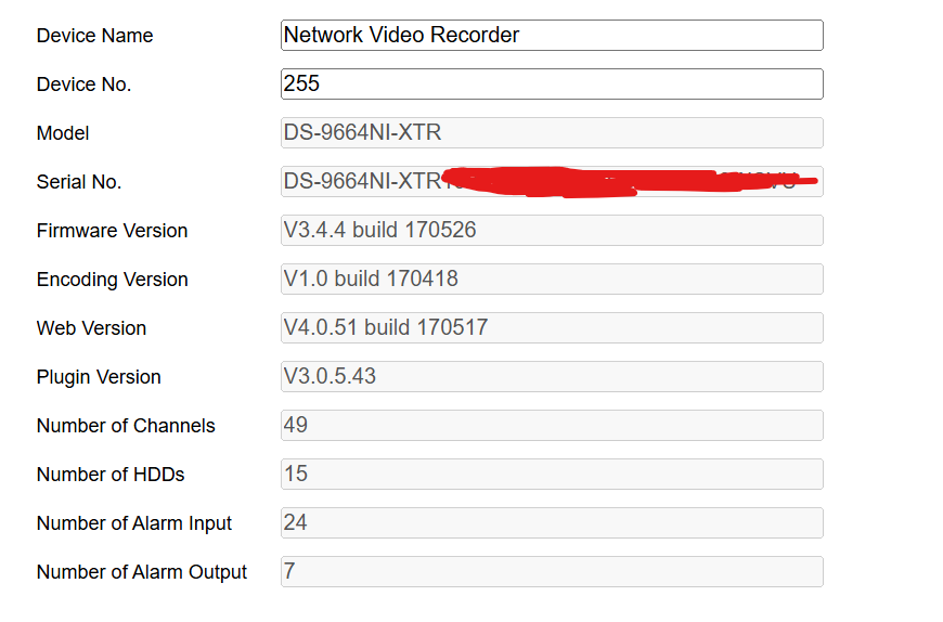

Oh my God!!@Dan the firmware worked for me, i have update the firmware of my 2 NVR's and its working, now im planning to update on one of the device that's in death mode, not powering up as of now, if this work on that ill be great thanks to you, as of now also Thanks as lot to help me out, the upgraded devices are under testing, few times the handing issue appeared with them, working from 9 years with us lets see how long they can, again thanks, and if you have any more to share i mean some more firmware of latest one you can share.
SS, this is the current status of the device after upgrade.

hiii i have done the upgrade to latest version which you shared. And under testing, will update if face any issue.
