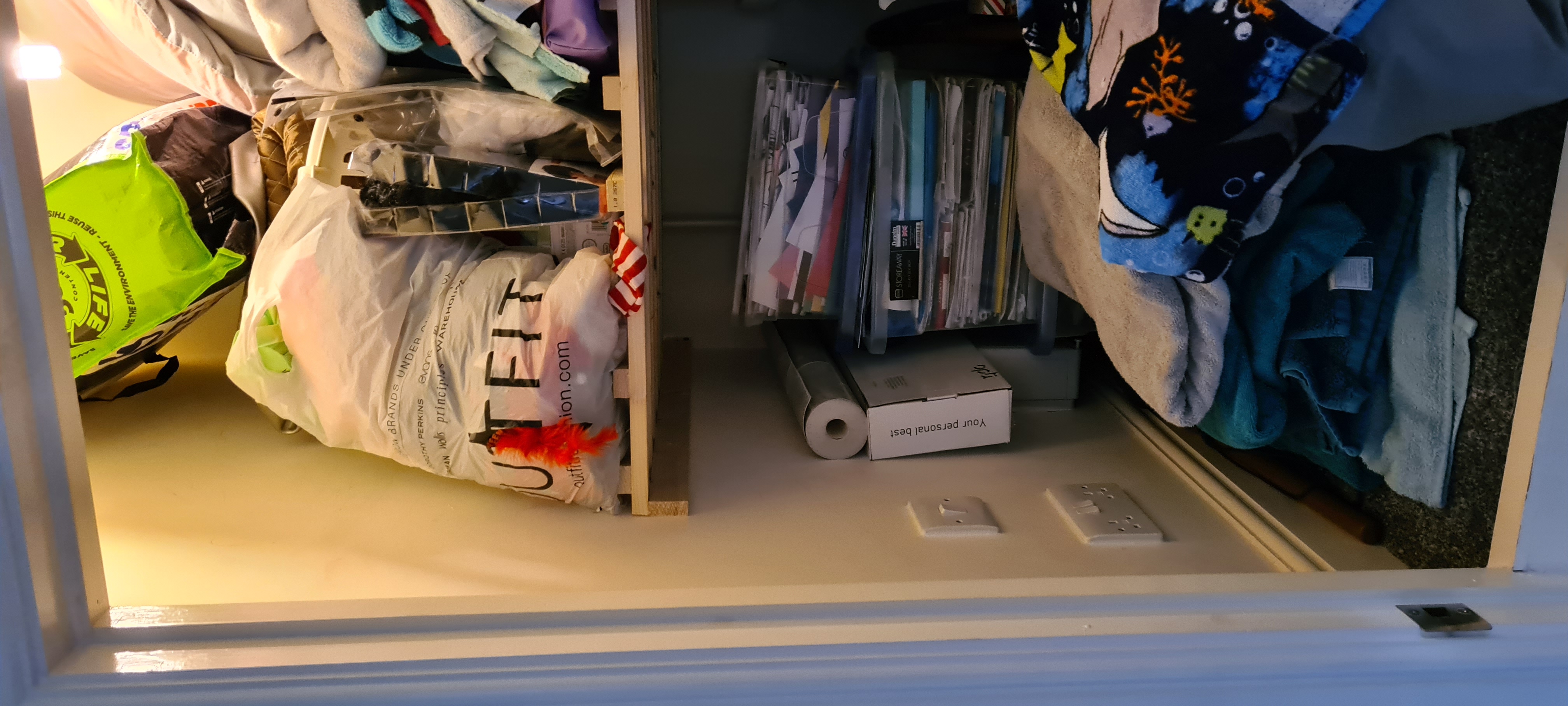

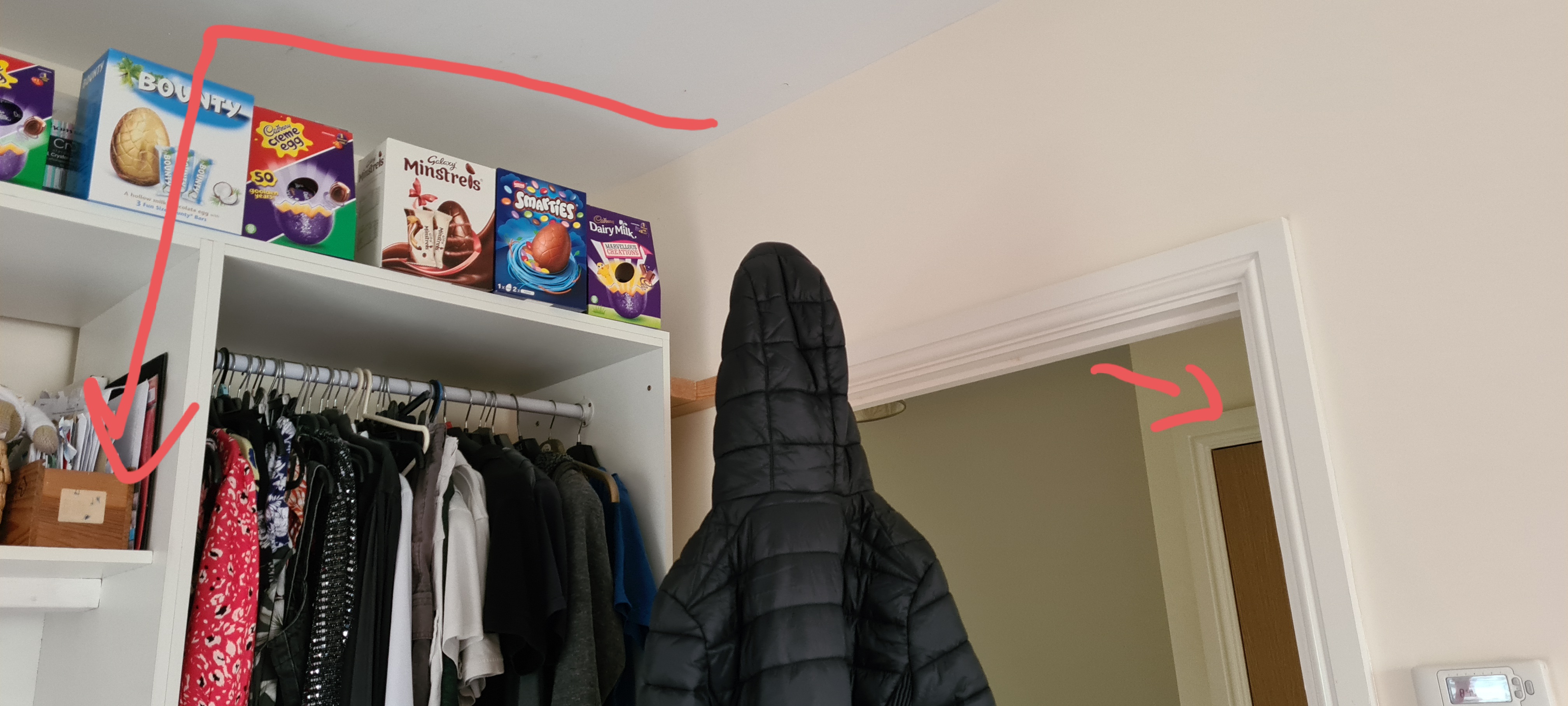

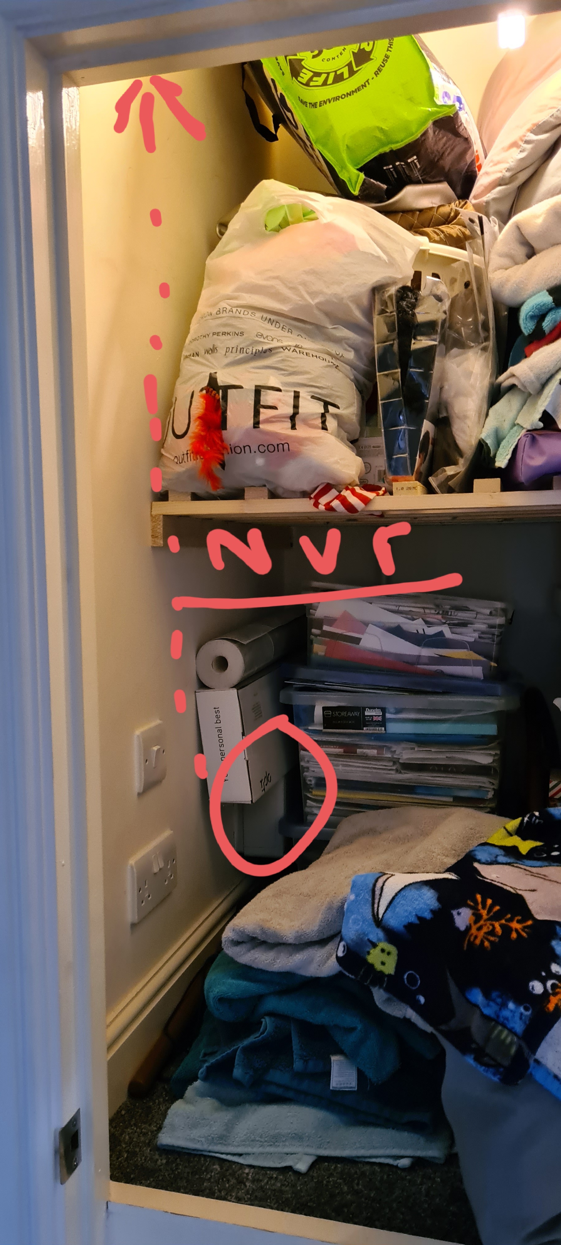

Second option is my towel cupboard. I could rig up a shelve and run wires up to the loft though the vm box already there ( below left) only need to run a hdmi to the TV then.

Yeah even better, you could just put an additional shelf 100 - 150mm under the lowest one so you're close to your power.
PS: I can't work out the second pic but is someone inside that coat with a very long head!
Ha. No. Its a coat on a door.
The picture was to demonstrate how close the towel cupboard is to the room.

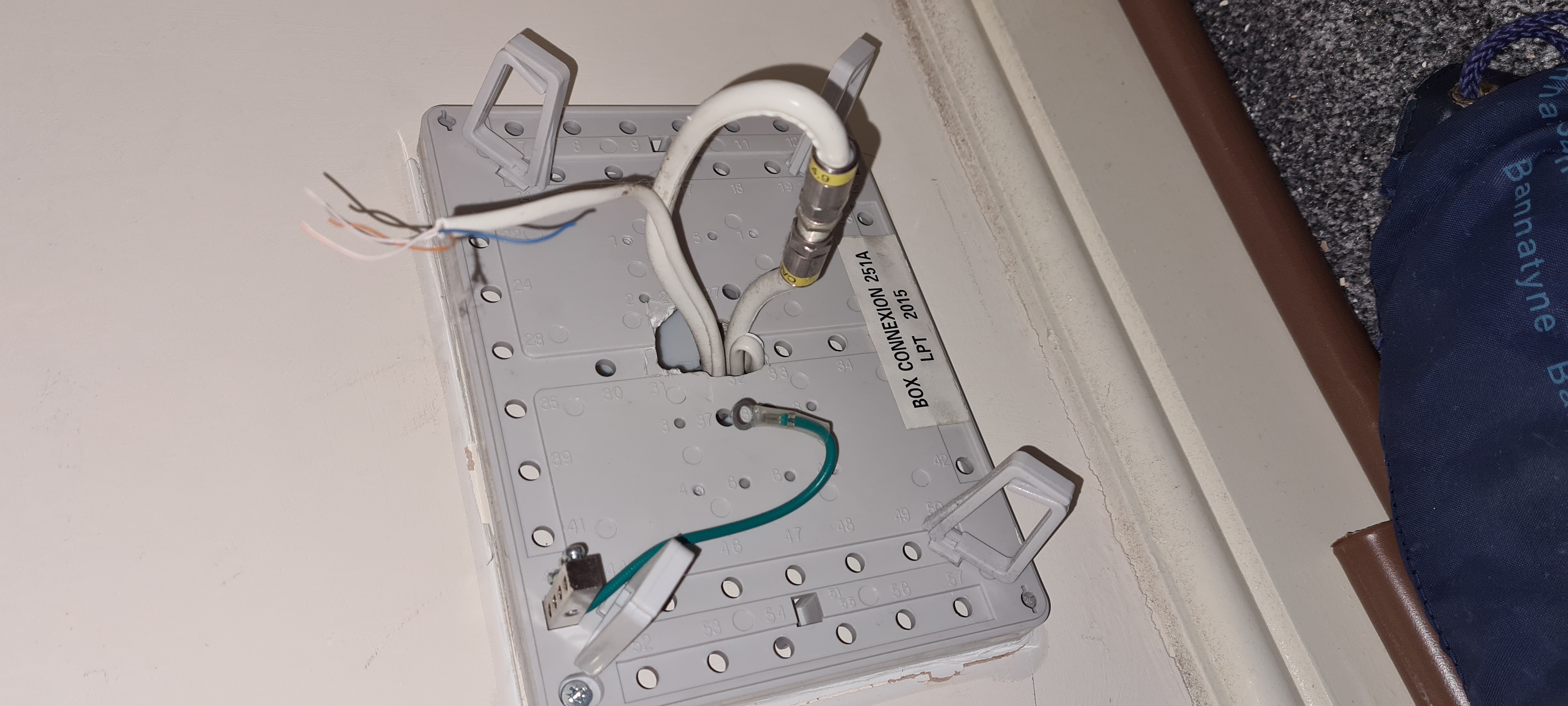

This is what is behind the box. I just need to figure out what the cables are.
That is just a Virgin Media shotgun cable - comprising an RG6 coax which could be for an upstairs TiVo box if it's in the airing cupboard and a CW1308 telephone cable - looks like the telephone line has been split off to another location (upstairs extension?) while the coax loops through. You shouldn't need to use that box for anything should you though?
No. I was going to run my ethenet cables in to the loft if it went upwards but it goes the other way.
