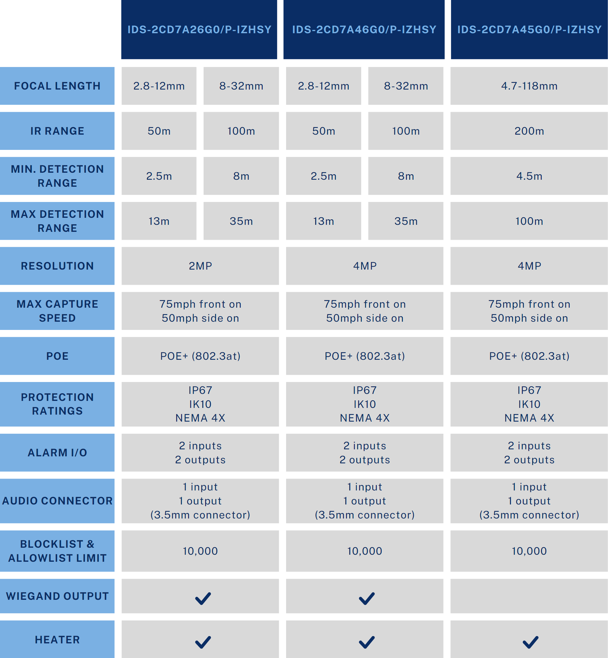

Key Camera Overview & Comparison Chart
iDS-2CD7A26G0/P-IZHSY
This is what we find to be the best-selling and most affordable ANPR camera which is also extremely reliable. Although it has just a 2MP sensor, this is sufficient for the camera to read plates when properly positioned and zoomed in. It includes all essential functionalities for basic ANPR and third-party integration, with two focal length options: a 2.8-12mm lens for close-range detection up to 13 meters, and an 8-32mm lens for installation at distances of up to 35 meters. Additionally, like the other two models below, it allows you to upload a blocklist and allowlist of up to 10,000 number plates which can be used for automatic alerts and barrier control.
iDS-2CD7A46G0/P-IZHSY
This model is essentially the higher-resolution 4MP version of the previous camera and has all of the same features. While the 4MP resolution is greater, this does not improve the detection range. However, in well-lit conditions, the sharper image can enhance sharpness and give more information about the vehicles, their drivers, and the rest of the scene.
iDS-2CD7A45G0/P-IZHSY
When positioning the camera within 35 meters isn’t feasible, this camera, with its 4.7-118mm focal length, is an excellent alternative, as it's capable of reading plates from distances up to 100 meters. Again, the 4MP model offers more visual detail in daylight as well. However, an important thing to keep in mind is that, unlike the other models, it does not come with Wiegand output. Other than this, it has very similar specifications to the other two models.
