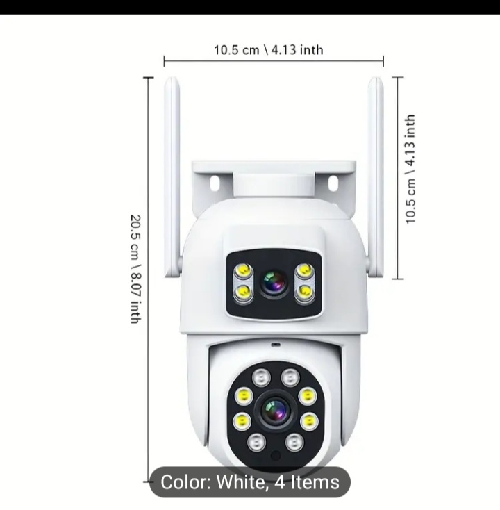

I've a wifi dual lens ptz camera without a lan port , can i connect to NVR for recording ?
yes it has a memory slot but prefer recording on NVR
thanks

what are the camera and nvr make and model numbers?
David
Hikvision with built in NVR
cam model : Y08
p6slite app
If the camera is connected to the same LAN as the NVR you should be able to add the camera to the NVR using the ONVIF or RTSP (usually port 554) protocols. You will need to know the IP address of the camera.
David
David
can't get throught the web interface ,,tried via the ip address but it leeds to no where...
