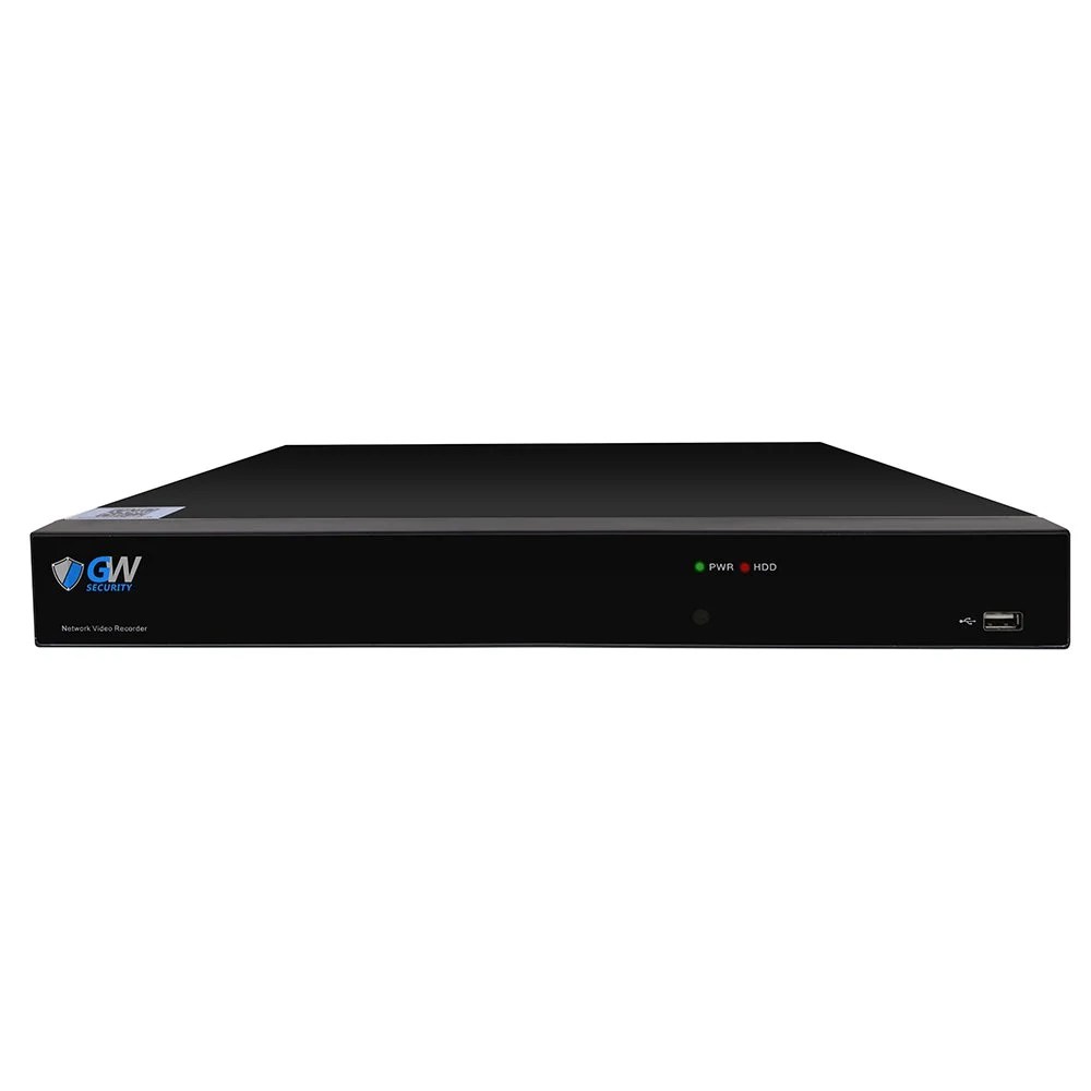

I have a variety of Hikvision IP cameras. Was looking at an NVR made by a company called GW Security. The NVR is model number GW5532NSN. It supports ONVIF, but wasn't sure if Hikvision cameras play nice with other NVR's.
This is the link for the NVR.
I have probably 10 different models of Hikvision Cameras ranging from 2MP to 8MP. Can provide model numbers if necessary. Any help would be appreciated.
Thanks in advance.
Hi @newguy
If the NVR is ONVIF compliant then you should be fine to add the Hikvision cameras to this NVR as ONVIF devices (depending on the Hikvision camera models you might need to enable ONVIF in the camera's network settings).
