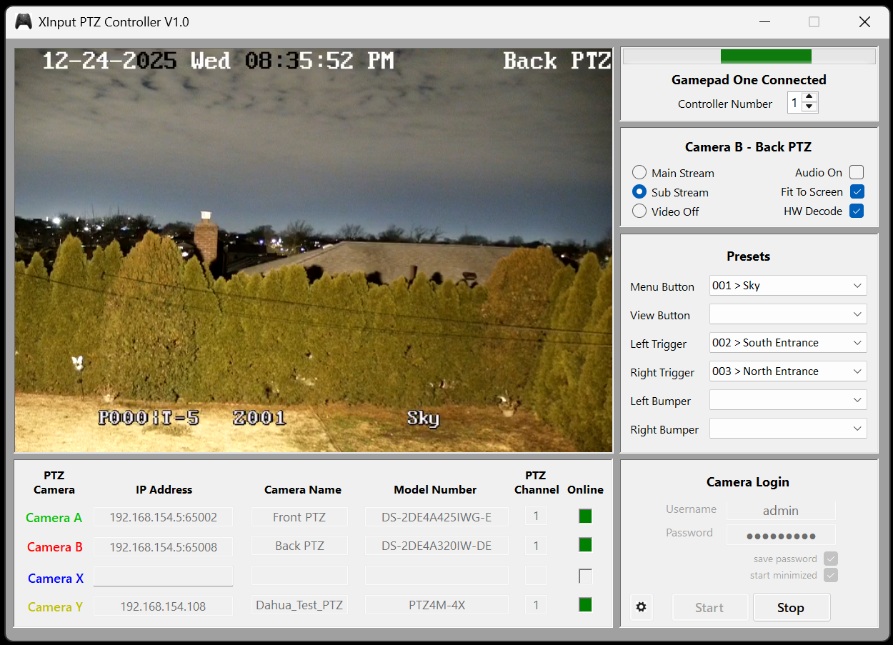

Howdy folks... I have created this Windows utility...
A, B, Y, X buttons select camera
Right joystick controls pan/tilt
Left joystick controls zoom
Dpad up/down controls focus
Dpad left/right controls iris
Camera presets can be selected using the other buttons as set in the utility
Here is the link to the source code on GitHub...
GitHub - jfitzee/XInput_PTZ_Controller

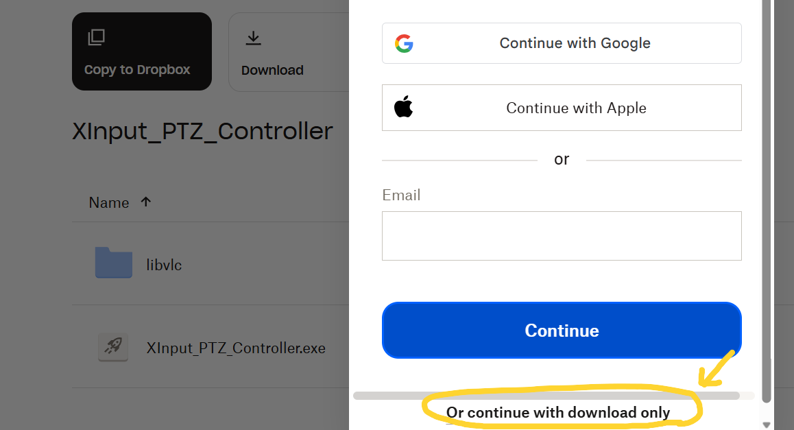

Here is a zipped compiled .exe if you can't or don't want to compile the source code:
Dropbox
I was testing the Dropbox link to make sure it works... if you don't have a Dropbox account, and don't want one, just click on "Or continue with download only" and you can download the zip file without having to create a Dropbox account:
