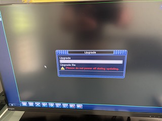

I have been using my NVR POE 4 Ch for at least 6years - Model NVR-7504p-P4 without any issues. However, just recently I get an error condition where the system automatically goes into an Upgrade mode and the system freezes.
The only way to navigate out of the frozen system is to power off / on. After doing so the system remains operational for about 1 hour and repeats the error condition as can be seen in the attached photo.

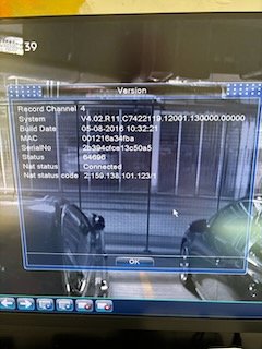

So what I probably need it a version of the firmware to match my original build version of;
V4.02.R11.C7422119.12001.130000.00000 dated 05-08-2016 as shown in the attached photo of my system after it goes into a frozen state.
Any help to source the correct firmware would be appreciated.
