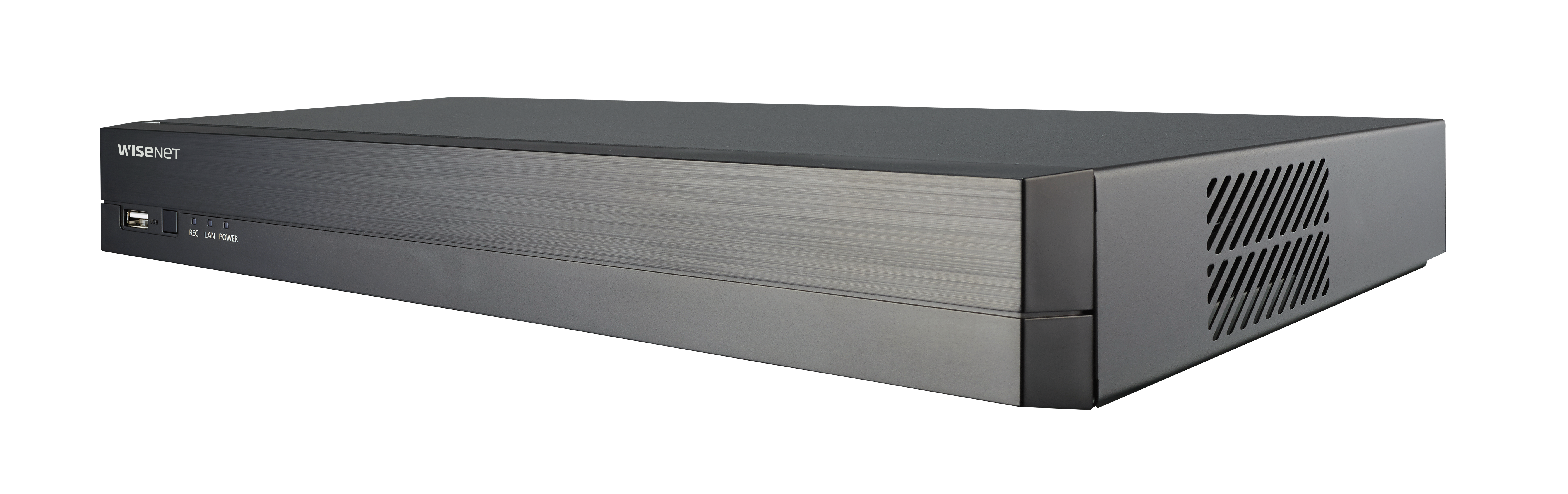

System 1:
You already have 2 x QNE-8021R and would like to add three more cameras and an NVR to complete your system. As you already have cameras from the Q series you should choose your remaining cameras and NVR from this range. With a total of 5 cameras you will need an 8 channel NVR, in which case we would recommend using the QRN-820S. This unit has 8 PoE ports in-built which means you can directly connect all 5 of your cameras to the NVR without the need for an additional/separate PoE switch.

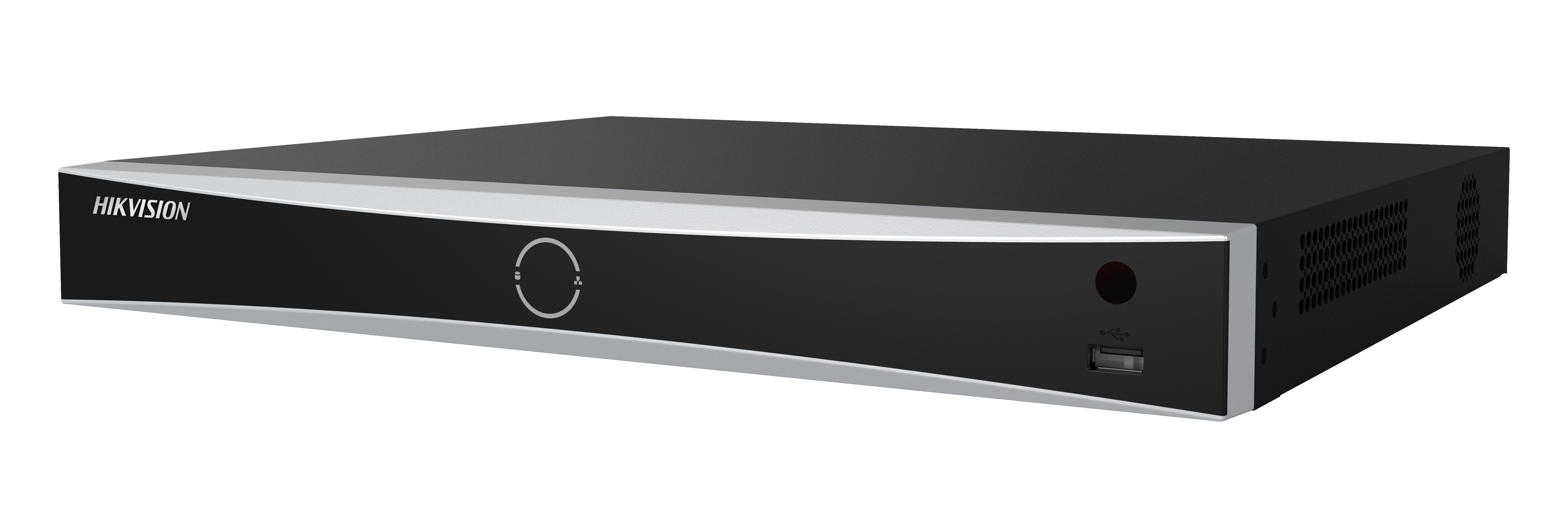

System 2:
You have 1 x DS-2CD2347G2-LSU/SL and intend to add three more of the same to start your system with the view to add a couple more at a later date. In this case, you will need to purchase an 8 channel NVR. The DS-7608NI-I2-8P has long been one of the most popular Hikvision NVRs and is still a great choice, however, if budget allows you could look at the newer DS-7608NXI-I2/8P/S.

System 1:
System 2:
