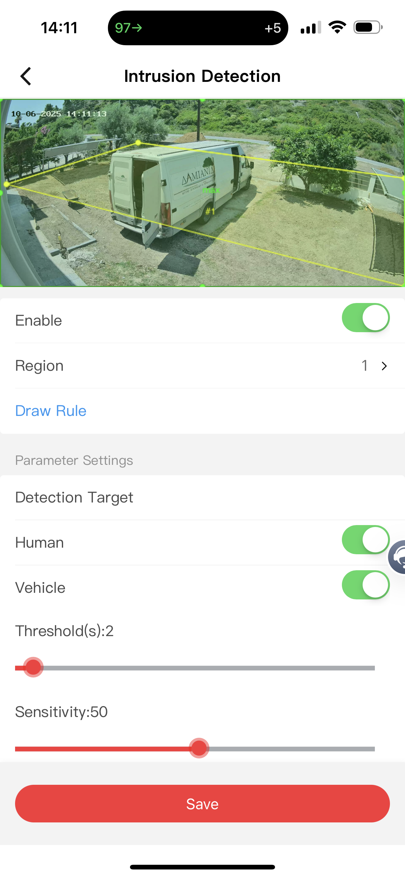

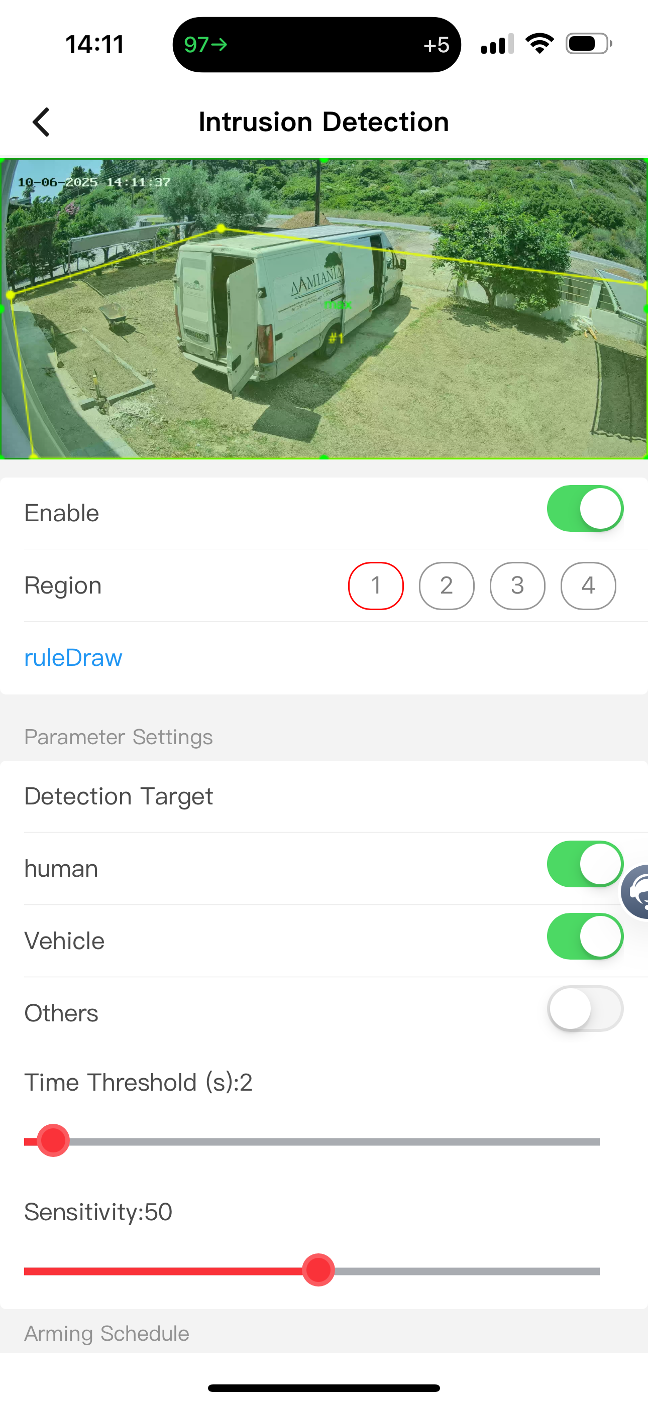

Please check this strange thing in case you know. I currently login from Hik partner pro mobile but this also appears in Hik partner pro web.
If I log to NVR settings and select the intrusion detection of the specific camera it shows me a rectangular shape. If I log to the camera settings directly (not through NVR) it shows me multi point area as also from Hik Connect app.
So what of them is valid and why this happening.
