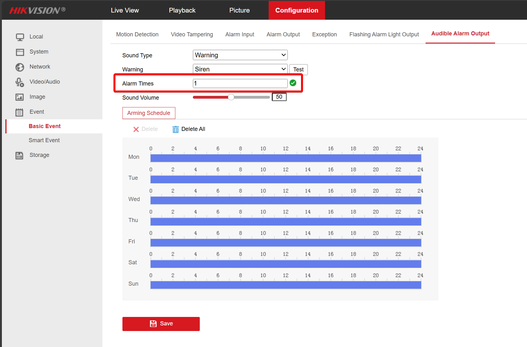

I'm guessing you mean one of the cameras with a speaker?
If so, log in to the camera directly, and go to Maintenance > Event > Basic Event > Audible Alarm Output.
If your camera is directly connected to the NVR then you will need to use Virtual Host to log in to it directly.
Then, you can change how many times the camera plays your warning message / siren in the 'Alarm Times' box:
